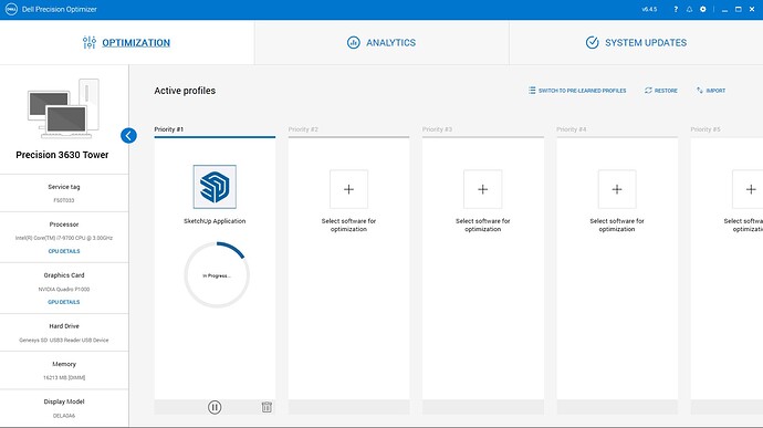

Regarding Dell:
My Dell computer is equipped with Dell optimisation software … I have 0% a clue what it does… hope it does not impact the SU problems?
