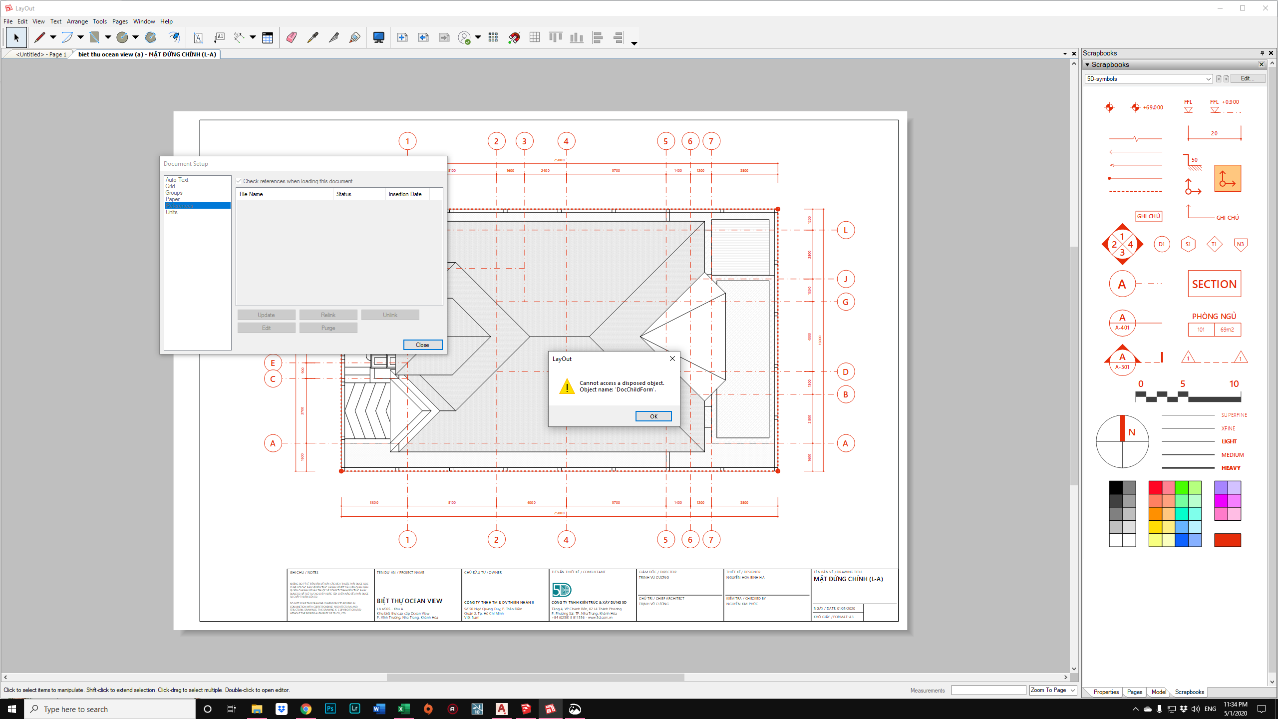

Today I have updgrade to 2020.1 version. I start using LayOut in just about 1 hour with a new file and I get many bugs and crash from LayOut and can not continue working.
Many bugs following:
  • “error code 10” and can’t save file.
  • Can’t not open recovery file because “…stagging…”
  • Crash when save
  • Crash from unknow reason
  • Rendering resolution…
When I roll back to 2020.0 version, everything is fine with the same file.
