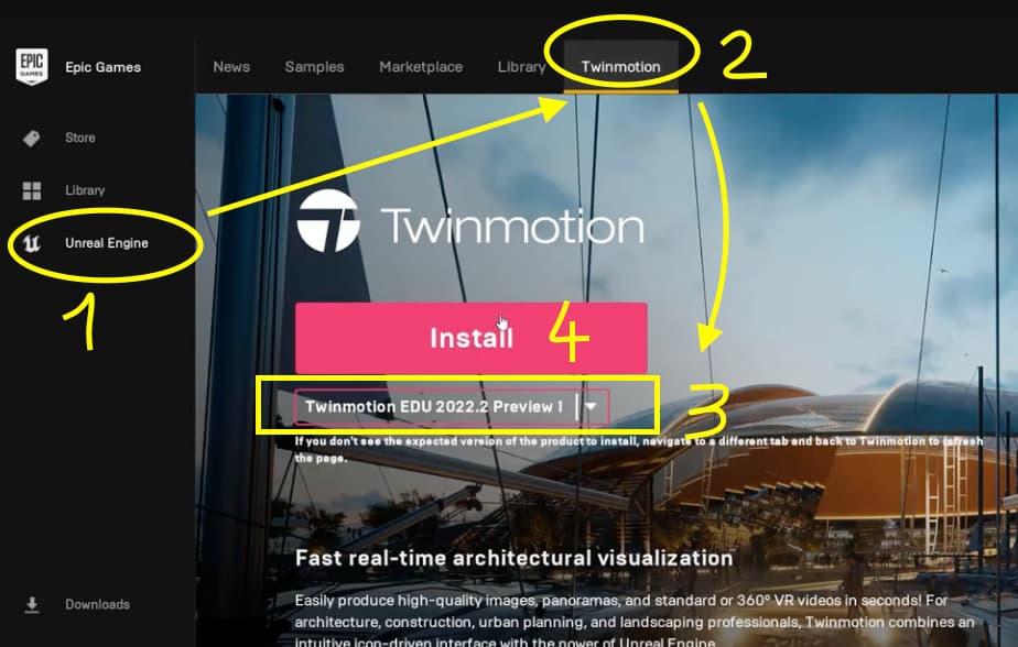

When I navigate to my files, TM doesn’t seem able to open any SKP documents. Do I need to export them to special file format first? When I’ve tried the plugin, it produces a folder with tons of files but they can’t be opened in TM either?
Thanks, I hadn’t found that, so will take a look.
uhh, from the interface, it looks like you didn’t download Twinmotion but Unreal Engine, the game / movie render that Twinmotion uses.
in the epic store, you go (on the left side) to Unreal page, and then on the top, you pick twinmotion. and install twinmotion. no need to install unreal engine unless you’re making a video game or some very advanced stuff
Thanks, that makes more sense now!

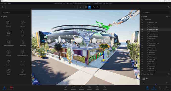

I need to “refresh” my already imported Twinmotion 25/1
with my newly corrected SKU exported fbx file.
WITHOUT affecting my trees cars and people inside but MOSTLY the trees
My PC graphics card is not the best so I put people and cars in my model
make some renders and then delete them again.
BUT I’d like to keep my wide variety of trees that are all in planters
along 4 cross sections of streets around my square center building
(a hopefully to become game)
I haven’t found an answer on how to refresh without loosing my vegetation
Can I save all my vegetation in one file ( types and position)
My model is all connected the center building the sidewalks and trees
as the model goes into the underground everywhere from under the center square till the “imaginary” facades and my corrections
affected all that underground space.
Otherwise I would import the center building only
In Lumion one pics any material and click (ctrl Alt and re-imports the entire file
from SKU (mine is 19) and all changes will apply but not affect the additional
actors like plants people cars etc.
Thank you in case you have an info who this re-import
can be done in TM 25/1
At the bottom, import menu. There if you hover on your imported file, there is an arrow symbol to update it.

Hello
As I see you are somehow familiar with SU > TM
I have this recurring problem
How to cut out a square from my STARTING GROUND?
I have my square building 18 levels over and underground
I can’t find one video that shows how to cut out the starting ground
in TM 24 or 25
most videos are very old
and it seems not many (I haven’t found any) addresses that issuse
After I import my model the starting ground does NOT recognize my
model’s limits and cut away ground from SU
Currently the starting land crosses my entire building throughout
and makes my model difficult for animations going down into the basement
one has to fly through that starter land which is illogical
I have tried to cut the land out BEFORE or in a different area
and then move the model to that place
That’s the problem when one doesn’t know the right words to look for in the UI
or click F1 to go online for documentation "starter land " is not enough to get there
Thank you
Unfortunately I melted my rtx3090 with twinmotion so I could not try the last release but its very worth using it.
I also paid for it and now it’s free so, even if it gives me grievances I still think it’s a great engine for sketchup users.
The worse it has is no decent furniture models.
You can’t cut a square out od the starting ground. You can do the following things, besides erasing it:
  • convert geometry into a starting ground. It becomes coarser than it actually is
  • use an height map as starting ground
  • shape it using ground tools
None of those are really perfect so I always opt for erasing it and I insert sketchup geometry as ground.
The problem is that only the actual ground can be painted and modeled with the ground tools, but that is not really a problem if you can model and texture the ground yourself.
If the geometry you are placing your vegetation in changes, you loose your vegetation. At least that’s what used yo happen in the prior versions I used. There have been some chamges in how vegetation is scattered recently.
What you should do, in order to preserve vegetation when you update the model is one of two things:
  • import the terrain independently from the rest of the model. You can do this by saving out components of the model and importing them independently inside twinmotion
  • or you can place vegetation without using the scatter or paint tools. Each vehetation you place manually will stay in place until you delete it. You go to library select an object like a tree, and place it at the model by clicking on it. Of course this is doable with trees, but not so much with grass.
