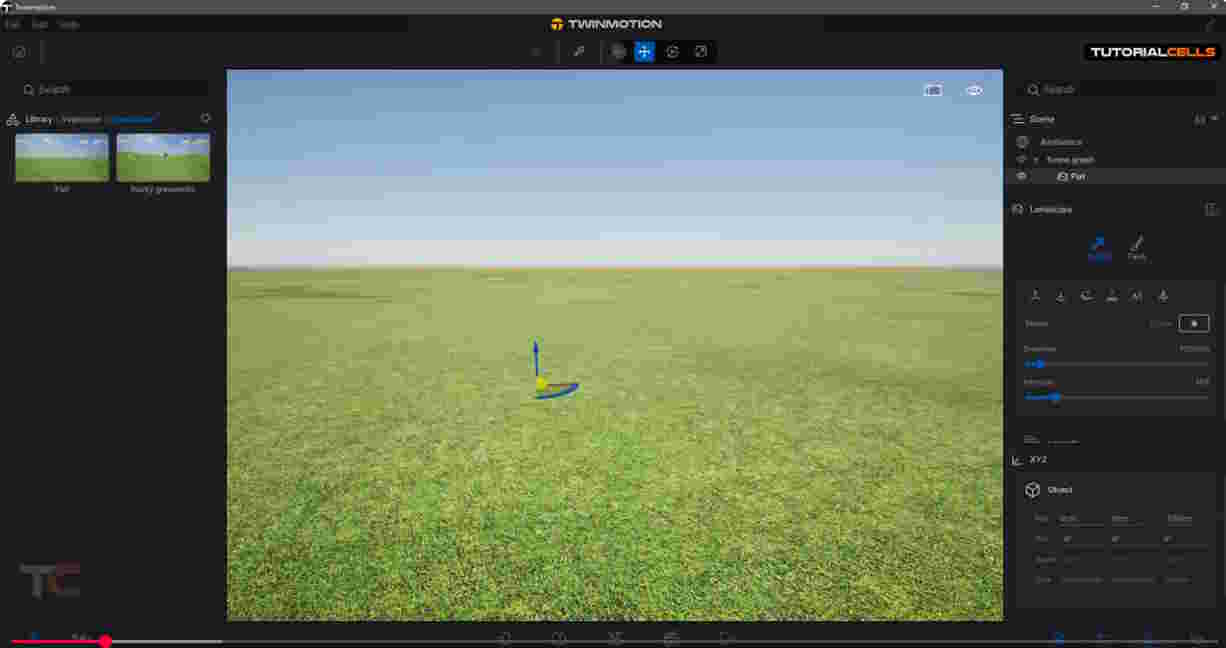

In your screenshot they are on the right. The pickaxe icon and below.
Simply select the terrain and the parameter panel on your right should contain them.

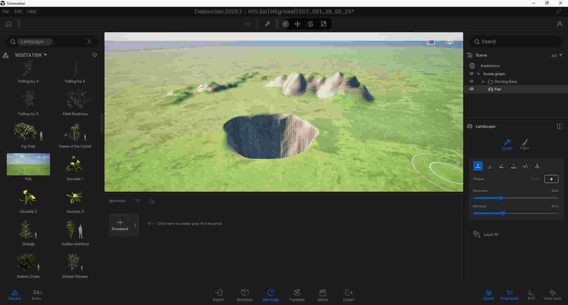

I managed to recess the terrain in a new project
Now will see if I can import my model over that (and restart all the trees)
or learn how to import this excavated terrain under my existing model
…Thank you

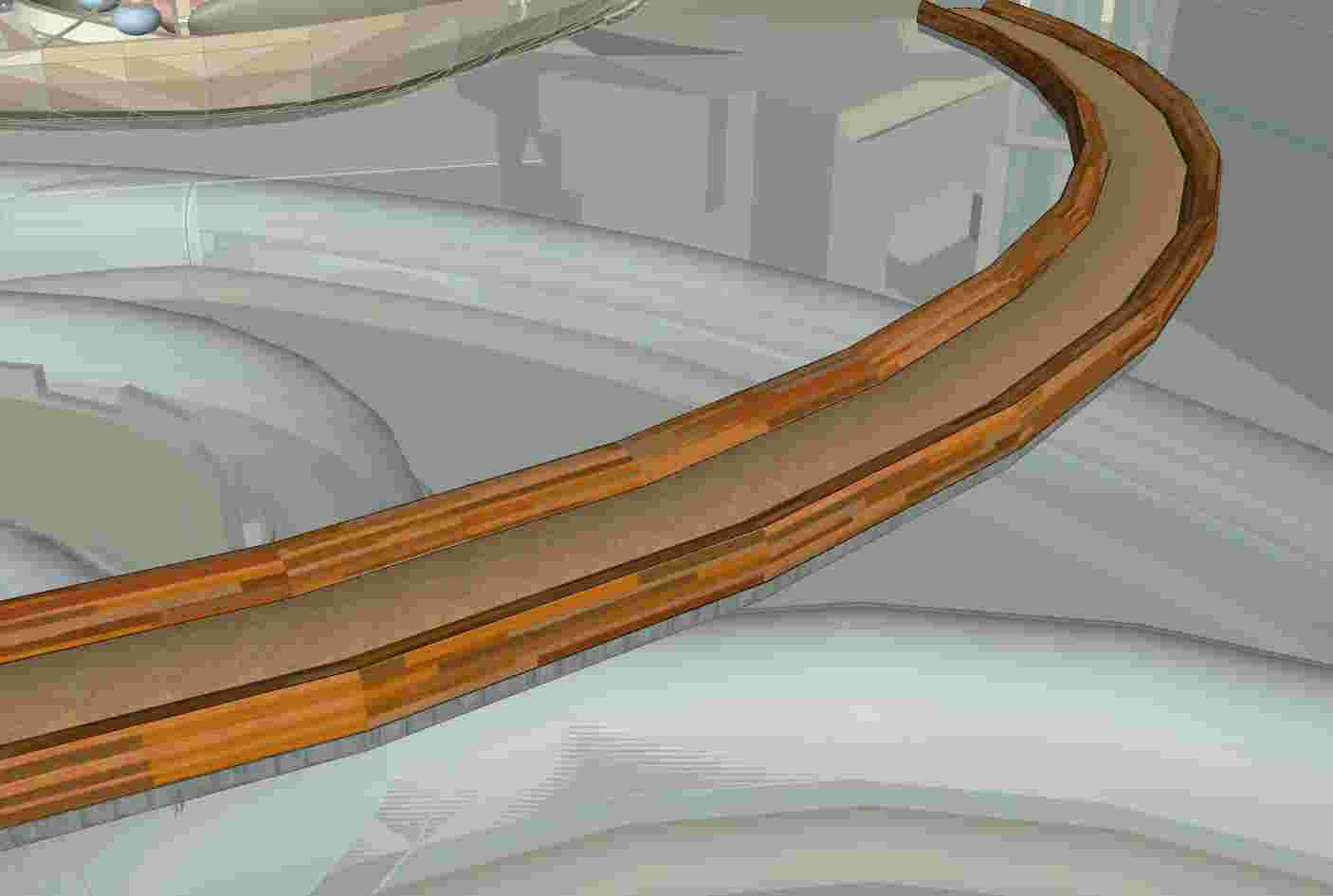

I have some simulated floating walkways made of wood with sand in the middle like (sandbars)
for people to walk on top of my lake
I painted the top with SketchUP sand material
I am quite sure I can change that to Twin motion sand material
but I wonder to make the sand look more irregular at the surface
to you think I can use the surface tools on it
OR does the surface tools ONLY work on TM imported " surface materials" like
the all over green land one?
It would be fun to give it some small different changes like results of foot prints
it is an imaginary sandbank like in the tropics Philippines etc. Only I don’t want to start from the lake bottom upwards and it would use up my water space and disrupt my other sub water structures
