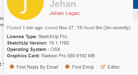

You’re having difficulty signing into SketchUp 2018 as your profile indicates?
The Sketchup I was fighting with is the latest release (Version 22.0.353), not the 2018 one you specified.

It would help us help you if you had the correct information in your profile.

Second, fix your forum profile. Put in correct information. As I wrote that information helps us help you. If you want correct assistance, help us help you by making sure that information up to date.

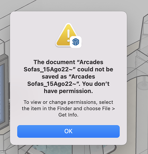

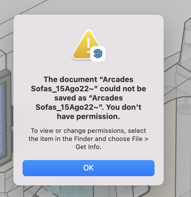

Hello Dave,
Again with the same error message and I don’t save on the Cloud but on my local HD.
What can it be ?
Any help would be appreciated.

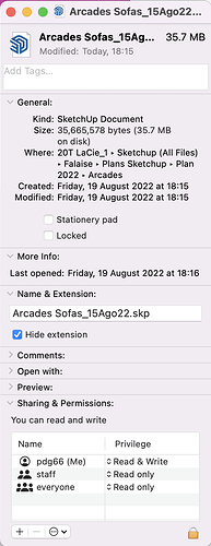

That’s a setting on the file : follow the instructions in the screenshot.
It might also be an indicaiton you have an issue with your Mac.
If that doesn’t work, then there some instructions you can follow here too
Repair disk permissions by running Disk Utility | Mac OS X (adobe.com)

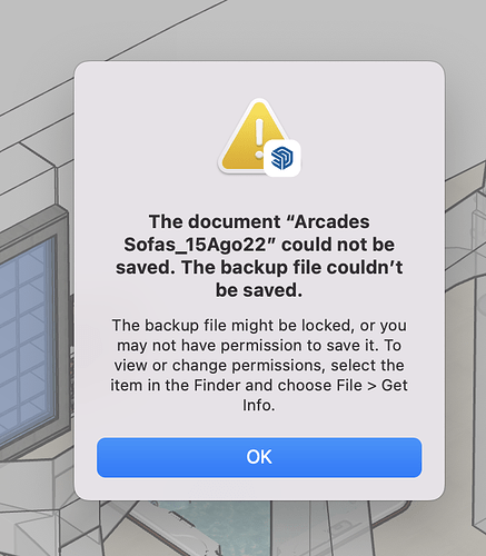

The file with the ~ at the end is the backup file. If SketchUp failed to save the backup into the folder where the original is, then you would see that error. As reading the original file is also saying that it is read only, that could explain why the backup doesn’t get saved.
What happens if you work on a file that is in your Downloads folder, or on the Desktop?

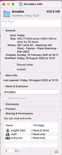

In any Finder window you can Command-click, or right-click, on the title of the window, and it will show the path to that folder. Could you do that for the folder that isn’t saving ok, and take a screenshot of the list you’re shown? You can type Command-shift-4, then drag a rectangle around the list, to screenshot only that part of the screen.

Here you go.
This issue is recurrent :frowning:
It looks like the top level directory is 20T LaCie #1. From what I can find, the # is an illegal character. What happens if you rename the directory and get rid of it?
What Dave said. Also, someone recently had problems when using parentheses in a file name. You have (All Files) as part of the path. I tested both things, and I don’t have a problem, but my macOS settings may be different to yours.

Looks like it is working now replacing “#” with “_” instead.
Let’s cross fingers and hope it works.
