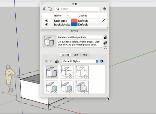

The column for tag name is the most important in the palette. Yet I cannot resize the palette and show more of the Tags name, so that I can identify it among other similarly named tags.
The “dashes” column, on the other hand, is given loads of screen real estate, although there is no need for it.
Best would be if the column width was resizable by the user.

Well, it appeared to be fixed when I upgraded from Mojave to Big Sur, but it’s all still a little unpredictable. I’m on 11.6 and the latest SU build and inexplicably it sometimes happens still. It works %99 of the time and the fault is so intermittent that for a while I thought I was crazy. But I finally caught a .gif of it happening, actually switching from not working to working mid operation.

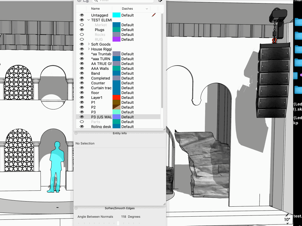

thanks for the screen recording tip. here’s me sharing my palette thing …
