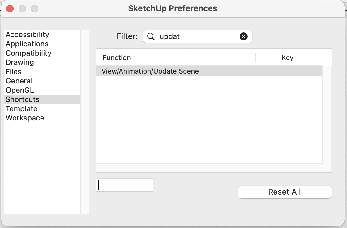

I saw the style update around 3:55. Couple of questions: Open SketchUp>Preferences>Shortcuts. Type in “update”, what is View/Animation/Update Scene set to? Also try Preferences>General>Reset all Warning Messages, it’s possible you have the pop up window that warns of updating styles turned off. Can you post your file here so we can see how it’s structured? There is a reason for this behavior, either on your machine or in your workflow.
Its set to nothing

Screen Shot 2022-04-08 at 6.25.24 PM
