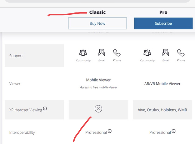

Mike- As I read it if you have a classic license IT SHOULD BE INCLUDED WITH A CLASSIC LICENSE.
3D Modeling Software Pricing | 3D Design Program Cost | SketchUp scroll down to XR headset viewing.
I’m having the same problem. I suspected it was a compability since my license is associated with my google account since i’ve had a perpetual license since 2008, rather than a trimble account. Good to know other people with normal licenses are having similar issues. It just sucks to not be able to show clients a feature that I am trying to promise.
X means no.

Classic (120/dollar) does not have VR / AR which is what you are pointing out.Pro Classic and STUDIO Classic do have VR / AR capabilities as pointed out on this page:

There is only ONE desktop license plan listed on this page and that is Classic. (The only one with a “Buy” button.) The other TWO are the subscription plans. (The ones that have a “Subscribe” button below them.)
The former desktop license was rewritten to remove mention of Make or free use, and was renamed the Classic license that gives access and use to ONLY: desktop SketchUp Pro, LayOut, Style Builder and Mobile Viewer.
As Mike so obtusely said, … Classic license does not include the VR viewers.
If you want to see it more plainly go to the Viewers download page, scroll down to XR Viewers and read what it says.

Same if you are asking about the Classic license, you are shown the Pro and Studio subscriptions as alternatives to what you first wanted. You don’t get the VR support in Classic just because it is listed on the same page in the Pro and Studio subscription columns.
