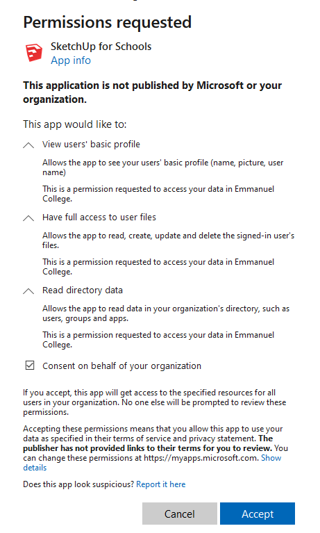

hi, I see now that I have to use my top-level admin account to allow this. I am concerned about how much access the app needs. Can you please clarify from this photo below what the app actually needs/does?

I can get past that using the top-level admin user - but my concern is just how much access the app is asking for… and if schools don’t have google or O365 how do they use this? Not getting much help from the moderators here…
@firebladez My apologies for not seeing this sooner, I’m glad that you were able to find the permissions screen.
To clarify, these permissions are used by SketchUp for Schools to allow the program to save user files to their One Drive and to retrieve and update the files when they make changes. For privacy reasons, we do not store any SketchUp for Schools user data internally, and so these permissions make it possible for you and your students to create, save and edit project files from One Drive accounts.
