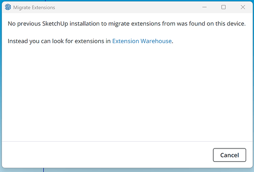

Can i ask if there’s any particular reason why I can’t copy all my extensions folder across from SketchUp 2025 to 2026?
I very much doubt any of the extensions have been updated to 2026, but when they do get updated, they will no doubt alert me in the Extension Manager.
Use the extension migration tool, which appears during the installation.

This pops up so I am outta luck there
Sounds like good idea though.

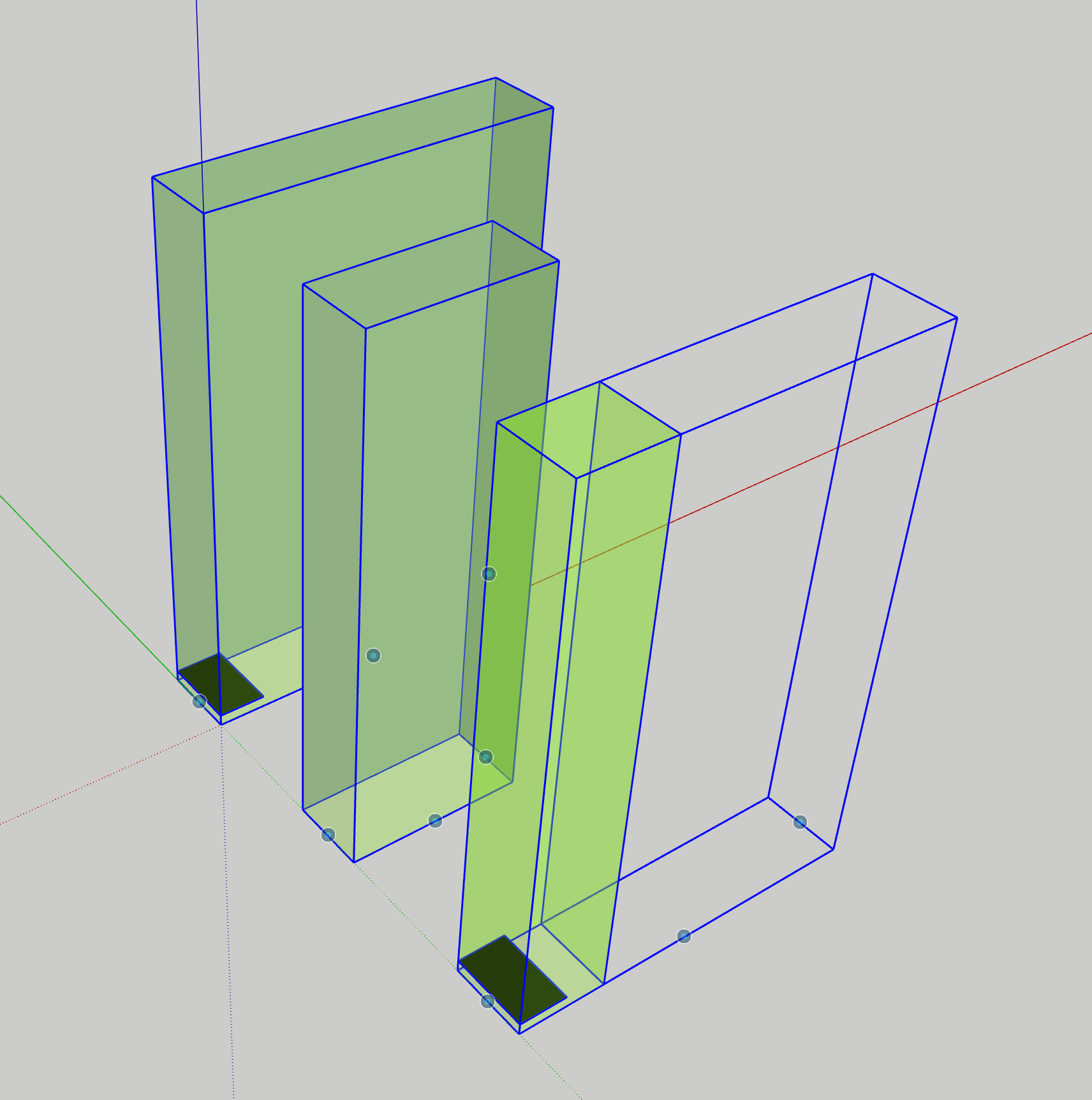

Here is an example (model attached), left to right:
  1. Component with an embedded non-scalable subgroup,
  2. Component without such a subgroup, scales without issue, and
  3. Component scaled with a non-scalable sub group, here scaling of the component worked, but the bounding box has returned to original size, destroying the component!
Note: The subgroup has embedded SNAPS to inward corners and centre outer end, you can see that they don’t appear when the move tool is activated.
The very COOLEST of options would be a shortcut that highlights all embedded snaps and turns off all other inference points!
snap test.skp (182.7 KB)
