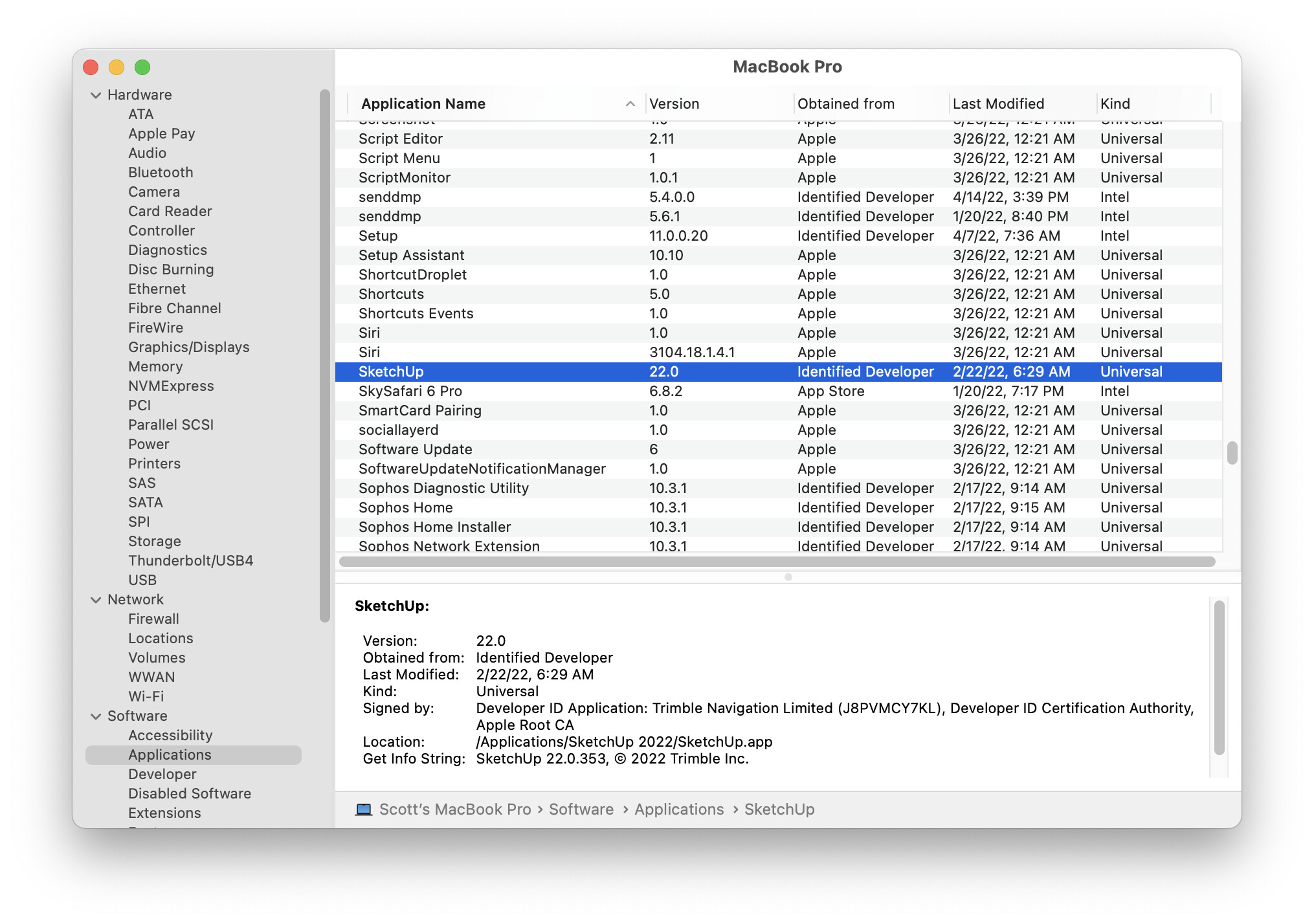

I am an Architect as well! I upgraded from a 2016 Macbook Pro which was intel based - which is all that I have to compare to. There is a drastic and noticeable improvement. Everything I am running is noticeably faster, so for me it was worth the upgrade. SketchUp runs “Universal” and V-Ray runs “intel”. but again the improvement is night and day as they say…
