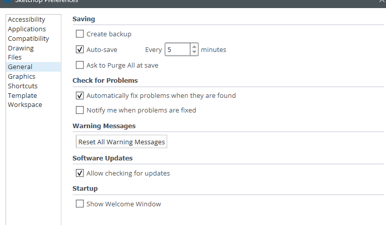

In SketchUp’s Preferences turn off the Purge All at Save feature.
Then set up your template and save it.

I turned off that option the day I installed SU25.

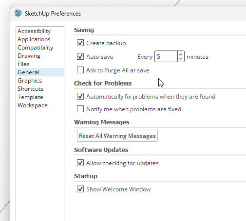

Here’s evidence that it works on my PC. Starts from my normal default template and then doing New from Template and selecting the one I made as a test.
Something’s different.
Here is mine…

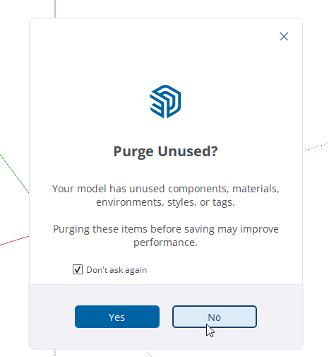

Just a thought. Turn on Ask to Purge All at Save. Then create the template with the tags and additional style(s) and save it. When it prompts you to Purge, tick the box for Don’t ask again and click No.
Good thought - that actually worked. I even added a new tag and it saved properly. If we ever cross paths, drinks are on me! Thank you.

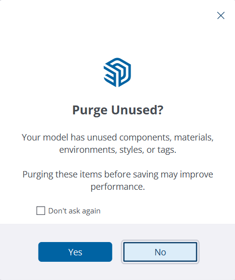

Dave beat me too it but the Purge Unused prompt pops up for me and I select “No”.
Pic that Dave already shared but I'm sharing anyway :)
yeah, whatever these guys said.
I had it too, but I saw Dave was typing stuff so I thought "meh, he’s got it :smiley: "
Good. FWIW, if early on you had gotten that message, ticked the box and selected Yes, SketchUp would silently purge unused stuff every time you save. And I think if you just unticked the box in Preferences with ever making the choice it would also purge silently.
