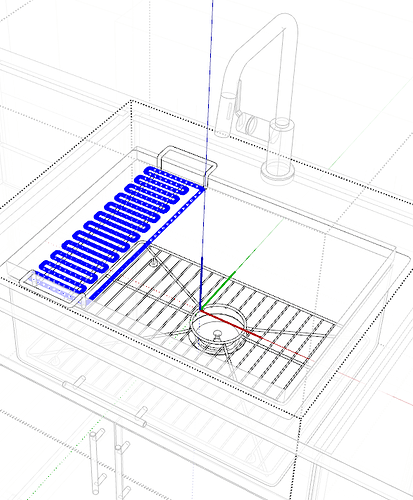

Looking at your SketchUp file I see some incorrect tag usuage. That might have come from components from the 3DWH, though.

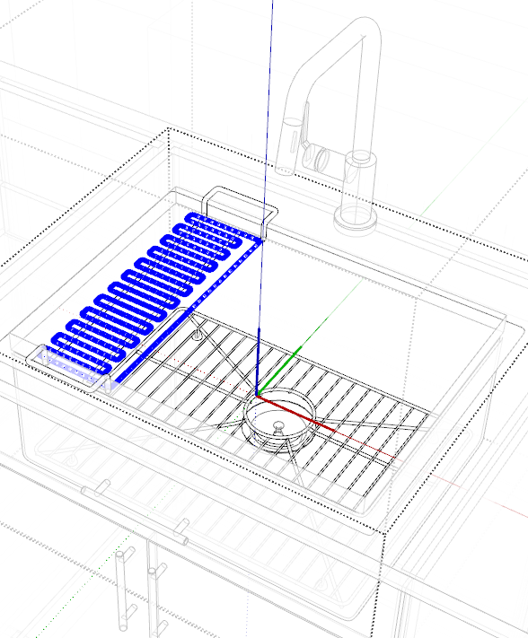

There is some excessively obese components in your model. Over 23,000 entities in just the wire rack in this sink is crazy.
That kind of stuff not only bloats your SketchUp model but it also means it take a long time to copy a viewport and paste it to another page. It’s entirely possible that you are exceeding the memory alotted for copied stuff. I was able to copy the viewport on Page #p and paste it to Page #10 but it took awhile to copy it.
I would suggest that a SketchUp file of more than half a Gigabyte needs to be put on a crash diet. As it is, your model is very challenging for any computer to work with.
I would also suggest that you use groups or components for the wall geometry within your model.
All of this stuff has a trickle down effect on your LayOut project.

Roger that. Some components come with every nut and bolt. The outside grill was ridiculous too. The model really bogged down with the barrel tile roof, which I had to purge.
I had originally grouped the wall base layer. When I discovered I was having issues I tried to copy this group to a new model and was unsuccessful, so I exploded the group and attempted to copy small sections with varying success.
Thanks again.
Yes. This is a thing to deal with and thus the reason for the advice to import components from the 3DWH into a separate file so you can eliminate the stuff you don’t need. Nuts and bolts are fine if you are trying to build that grill from scratch. If you only need to indicate there is an outside grill on the patio, though, the hardware is fighting you all the way.
