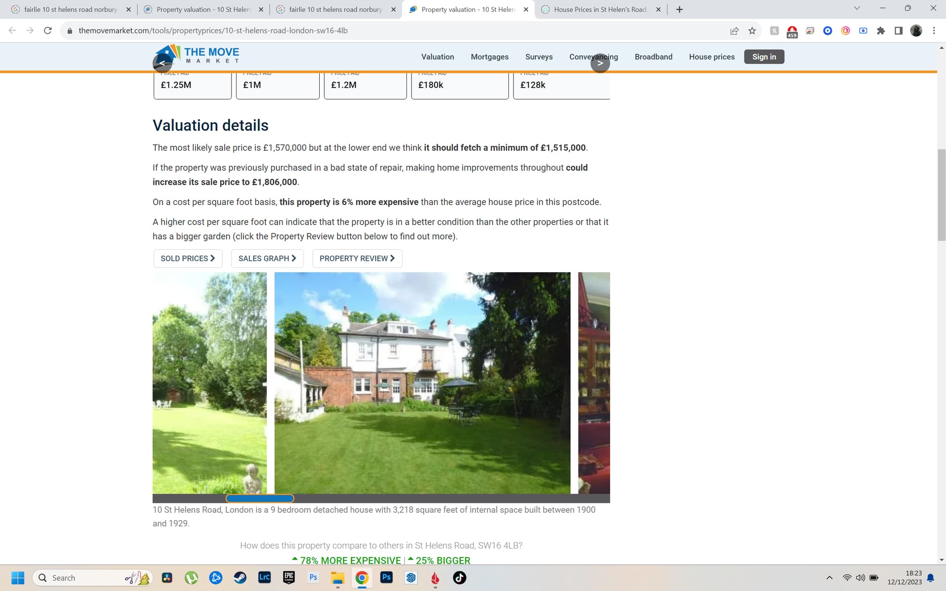

Need help making my model watertight in time for Xmas! This is my Nans old house that I have made as a modular “dolls house” I only have images and memory to go from, I have succesfully printed the first two floors but the third floor and roof cap are proving beyond my novice capabilities, I have attached all files if anyone can advice how to make them all line up, I have spent about 50 hours on this project so far. She really means alot to me and I wanted to show her how much she means to me!
I have succesfully printed the first two layers but nothing is as alligned etc as I would like, thanks for any help!
