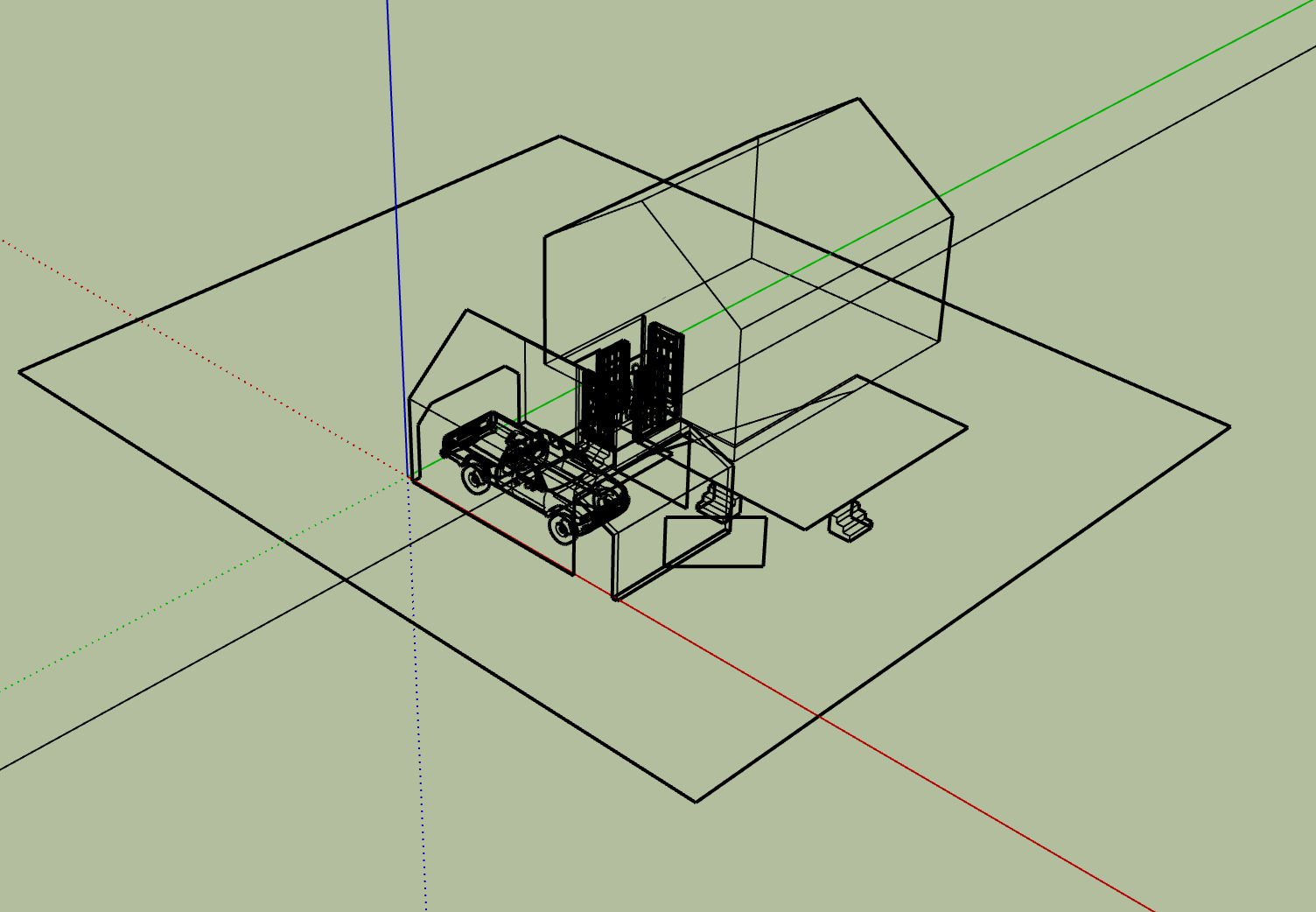

I can’t tell after the fact how you did it, but you have a face and its edges an insane distance from the model origin, and that is making it impossible to zoom correctly. I deleted them and restored the camera to sanity. Here’s the result:
PIFF.skp (1.6 MB)
How did you get it back? The only way I could see a piece of it was in 2 pt perspective
I used a Ruby snippet to search for entities very far from the origin and deleted each of them. Then I used another snippet to reset the camera (sometimes when the camera has gone to outer space, it can’t figure out how to do zoom extents and has to be forced).

I managed to recover all the components in the model and copied them into a fresh file. They don’t make sense in their current arrangement so I guess this is some kind of April fool, right?zap.skp (1.6 MB)
