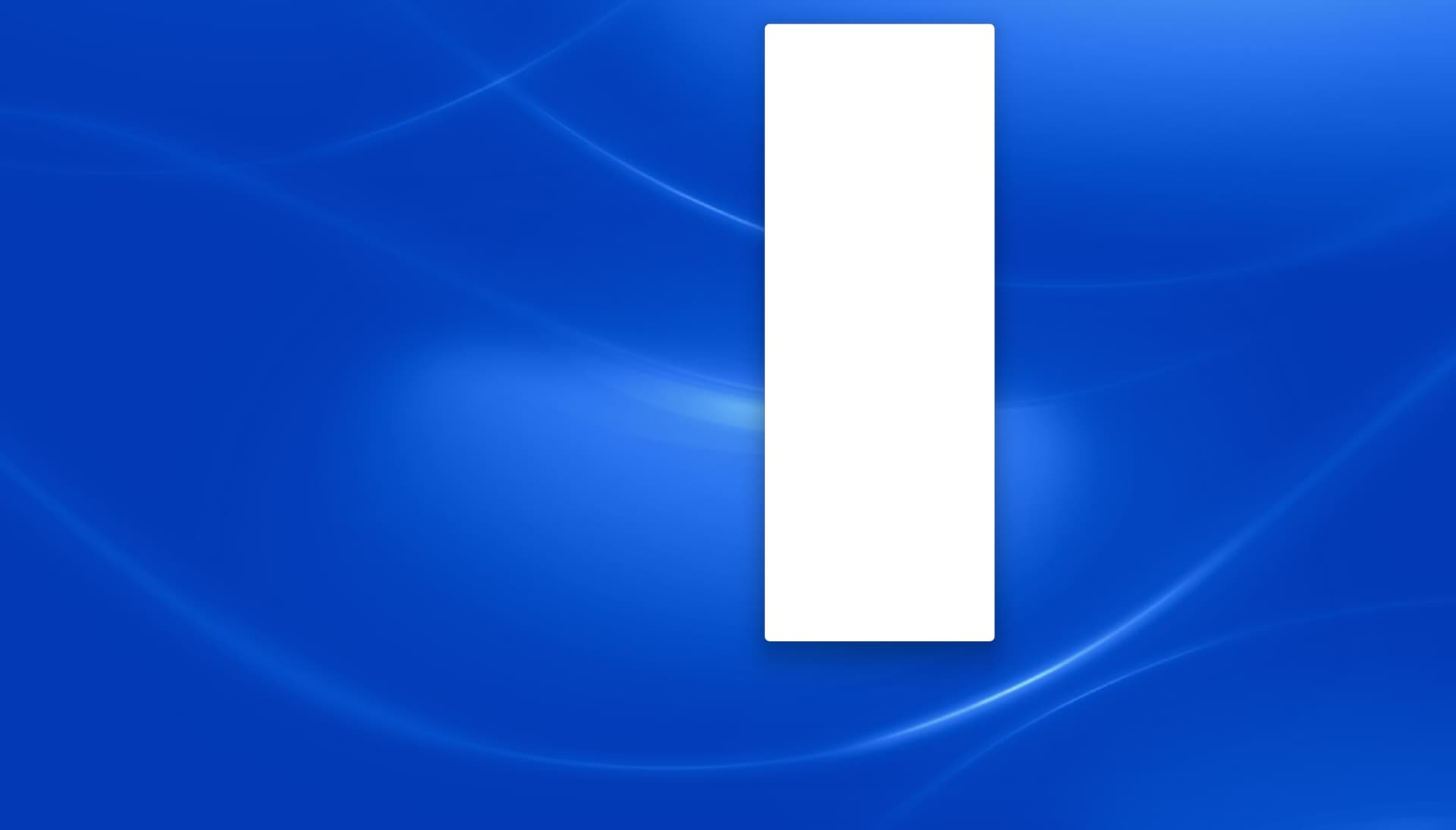

Tried that and things got even worse.
Now I have a blank window stuck on my screen that won’t close.
It stays whether SU is open or not.
Well that’s fun.
