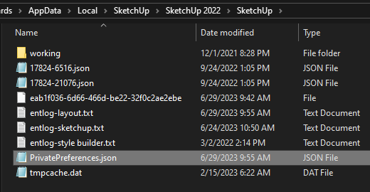

Thanks for add ing the instruction.
PrivatePreferences.json is in \AppData\Local\ not AppData\Romaing.

That worked. Partially.
It was in a slightly different location.
C:\Users\GSB\AppData\Local\SketchUp\SketchUp 2023\SketchUp

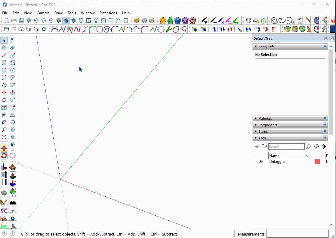

But I still don’t have a Plugins pulldown menu.

There isn’t a Plugins menu. Hasn’t been one for a few years. It was replaced with Extensions.
When you go to Extensions> Extension Warehouse does the window populate?
ew
Yes it does!
Thank you. I was reading old posts about the plugins window, and didn’t realize it had been replaced.
Thank you for your help.
Everything appears to work fine now.
