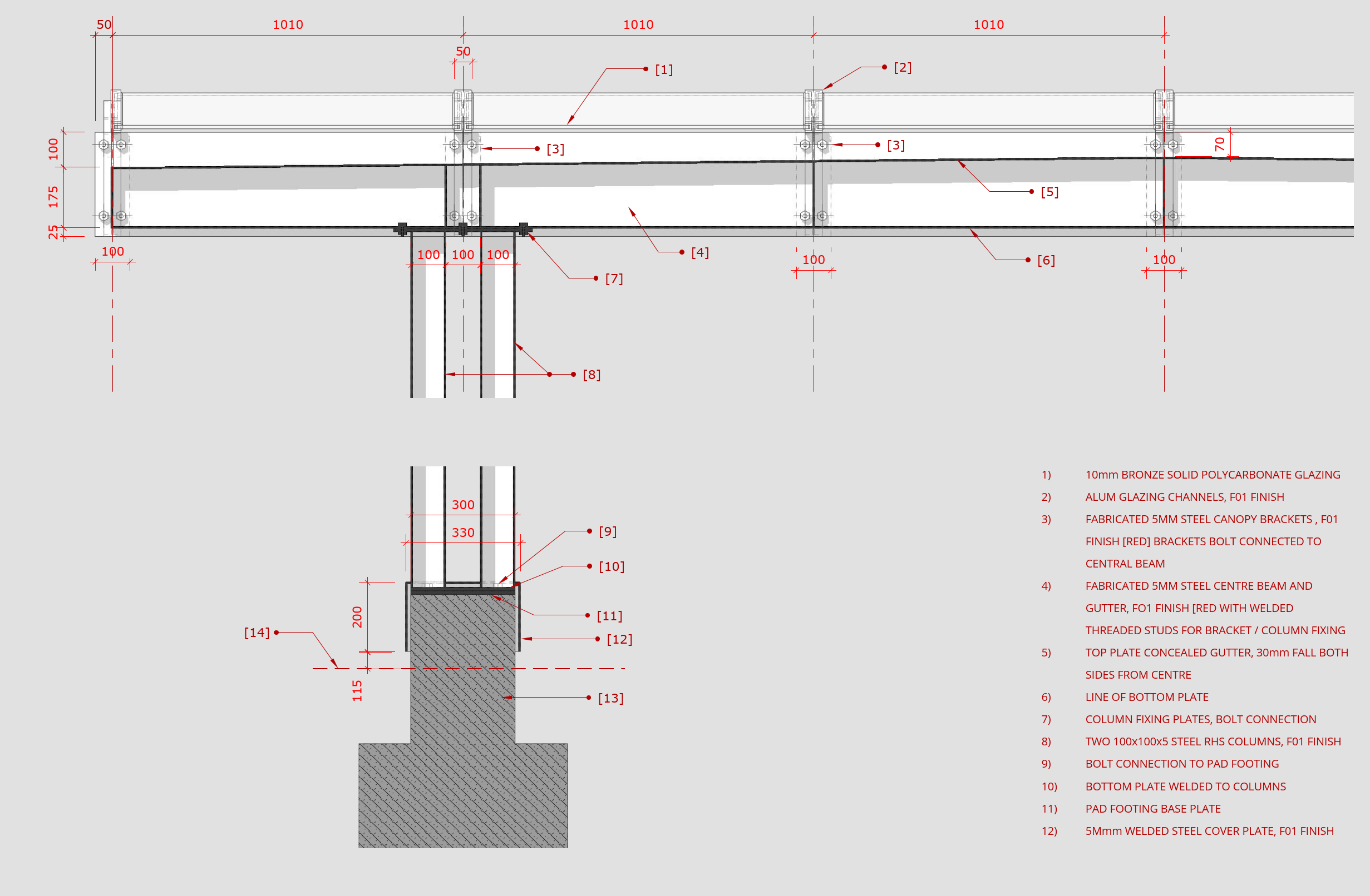

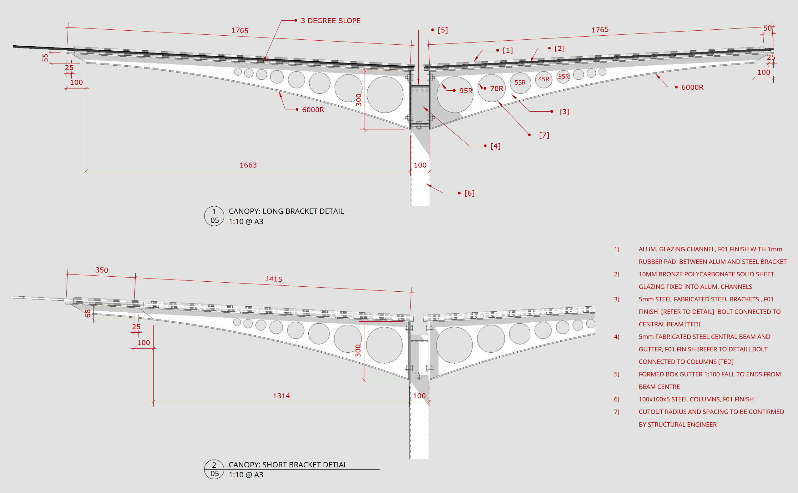

I avoid the lineweight workaround problem by using colour, shadow and fog for depth
PS, prefer numbered list notes as these are much easier to convert to alternative language (vietnamese in my case) or bilingual without affecting the drawing…

Fog only works in raster mode I believe.
I find the line weight quality not good with raster and attempting to mask with vector linework doesn’t work for me.
But, yes, using shadows for elevations and sections is a good way of adding depth perception.
Yes true Paul… might also work in hybrid mode too… will check… just really just showing there are alternatives to lineweight in defining form…technology now offers many alternatives to traditional lineweights… Hell, I prefer just to give them a 3d model with all the information linked or embedded and be done with it… but until get a universal open source data exchange model this is what it is… at least I dont produce anything on paper any more… all electronic
PS , Hybrid works similarly
