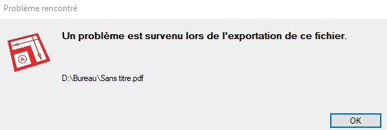

Hi ! here is what I have each time I try to export to PDF from 2 weeks
I uninstall all the new windows update
Unintall SU 2019 and Re-install (administrator)
Hope someone can help
Thanks

What if you print to PDF instead of exporting ?
You might also want to look into this thread Layout 2018 can't export PDF error "There was a problem exporting to this file" - #179 by Ninjoe
But I’m starting to think you have troubles with your SketchUp installation. Earlier this day you told about a user that had been deleted and from what I saw, in a bad way.

I never have any problem before, but this week I have something to lear
Yes it work with the print to PDF

I reinstall it, maybe that steel cause the problem
Make sure you right click on the installer and run as administrator
Yes I run it as administrator each time
