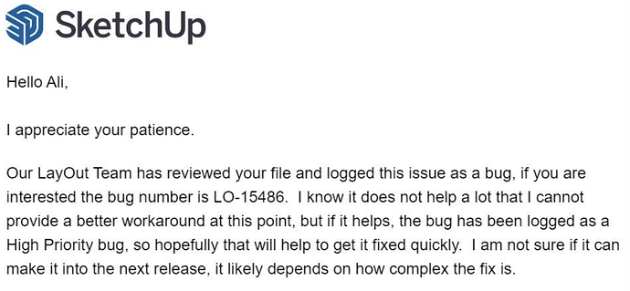

FYI - we received this answer from SketchUp. Thanks for all of the help in the meantime confirming there is a problem and suggesting a work-around. I’m almost back on track with the deadlines I missed this week & the work-around is working, but I’m salty that we have to resort to it - finishing the work is much slower, and I don’t work fast in the first place!
This has also helped with my existential question - we are going to try to ride out issues with '24 and avoid upgrading again for as long as possible. (Which might mean living with the dimension work-around in the long term too, I’m not sure it will be fixed before they release another version that I will avoid because there will be new “bugs” lurking.)
I appreciate all of the help! In the past I didn’t spend much time here because SketchUp was reliable and we didn’t have issues to post. It’s good to know this works but I also wish I wasn’t here having this conversation - LOL.
