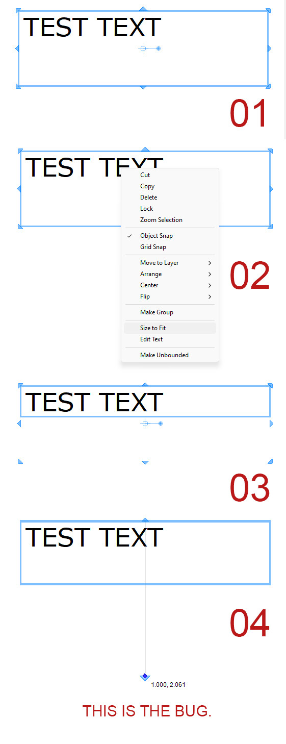

For the last few years, I have been completing my entire architectural process in Sketchup producing the types of documentation shown here.
These drawings are a mix of native Sketchup and layout tools and free and paid plugins.
I have come to love using Sketchup for this process as it allows the freedom to create drawing systems that combine the best parts of 3D and 2D documentation.
That said, there are a few things that would make the process of documentation much more seamless.
The following is a list of Bugs and changes I would like to see implemented in future updates.
These have all been found in Windows 11 and Sketchup Layout 2023.

  5. BUG. When resizing a label text box that has been sized to fit will reset the text box vertical dimension.
  6. BUG. When resizing a text box with shrink to fit the scale/bounding box does not update until the text box is moved, copied etc.

I reported this one a few years ago – it happens less, but still happens:
I do a Make unbounded then an Undo to reset the bounding box.
For a single line of text you can of course invoke Make unbounded. This does not work with multi-line text unless you have done returns to make a new line.
Did this happen in previous versions? I’ve noticed it more just recently :thinking:
