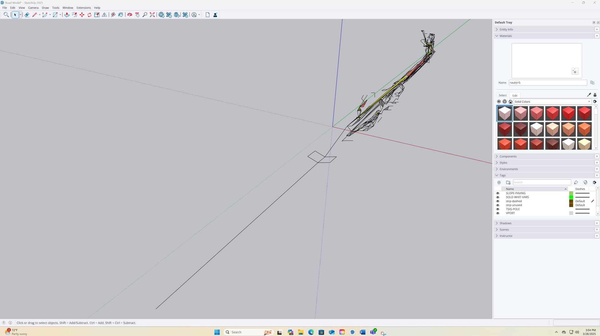

I’m not finding any geometry in the distance. This is everything in the model
You mean that giant bounding box isn’t a clue? There’s something inside that huge group/component that surely needs to go. Open it for editing and drag a right to left selection window around the distal end of the box. See what’s selected. Press Delete to make it go away. Again, make sure all tags are visible as are hidden geometry and hidden objects.
I got rid of that geometry and repeated the process with toggling the camera perspective and then zooming to extents and still nothing.

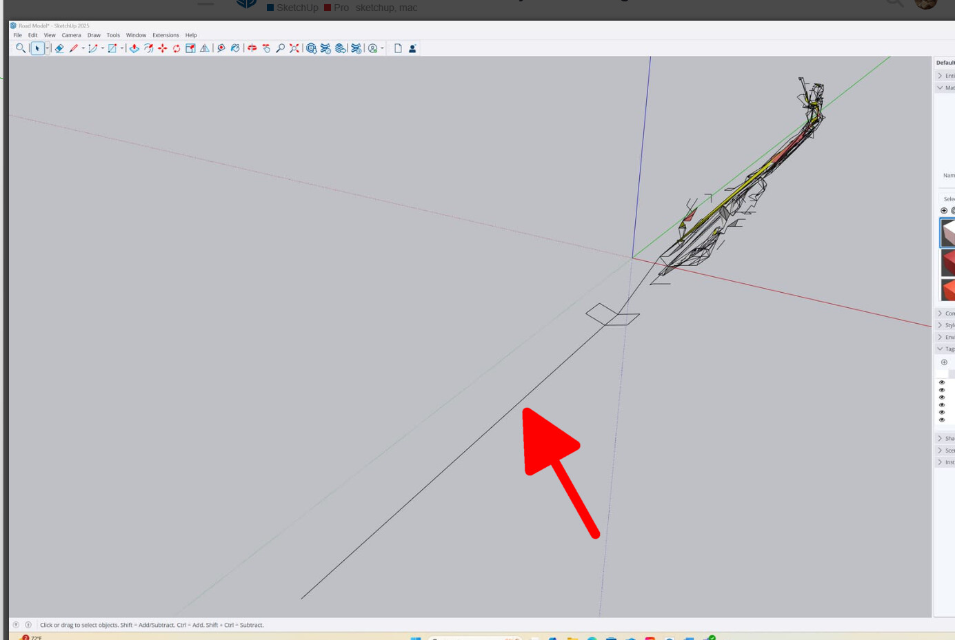

What about this long edge? Is that needed?
The model kind of looks like a mess. What is it supposed to be?
It’s a roadway model. Getting rid of the line and boxes coming off the end doesn’t help.
Keep looking. There’s still some junk. Probably some tiny edge segment. We’re just going round and round here. Zoom Extents zooms the camera so that all visible entities will be encompassed in the view. If it still looks like the model is too small, there’s still entities located at a distance from the model and you would need to either find them and delete them or find them and move them closer to the rest of the model.
