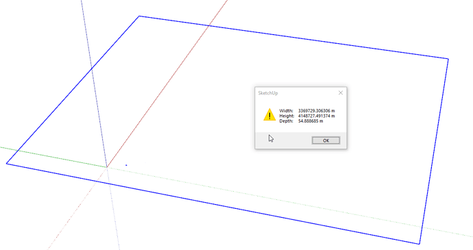

I’ve never seen a model this badly constructed before. I copied one of the Master Plan components into a new file to have a look at it. It’s no wonder you’re having problems. Look at the size if it.
It’s 2578 miles wide and 2094 miles front to back. It’s only 2450 miles between New York City and Los Angeles.
And there are two instances of it in your model.
I’m going to suggest that you start over with this project. I cleaned up the master plan component to make it a reasonable size.

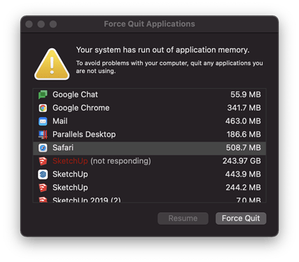

I set an extension going, that should fix rogue geometry issues. It’s been running all morning, but ended up taking all spare memory. Here’s a screenshot that shows SketchUp was taking almost 244 GB of memory, at the time that I force quit it.
Told you it was a beast :wink:
