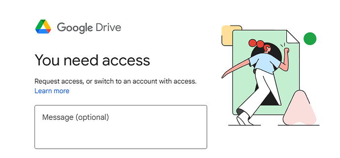

I’m trying but you need to make the file available to download.
This is what I get when I click on your link.
You can download it now.
