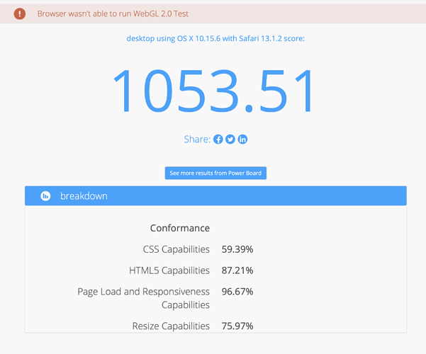

You’re showing off now! I did do a test with Safari set to use WebGL 2.0, and got 1200. Later on I will close all other apps, and see if I can beat that.
I was teasing. You could try again later when only Chrome is open. But this is just for reference, hopefully some people will come here with the hardware acceleration issue, and your figures will help them to know what to expect they should get.
It was screaming along and then reported that several tests couldn’t be completed because my network was unstable. Due to this it wouldn’t calculate a final score. Network instability is a common issue at my Summer place where we have only slow DSL that can be overloaded if any two things try to use it at the same time (there are two computers and two phones all competing for attention!).
