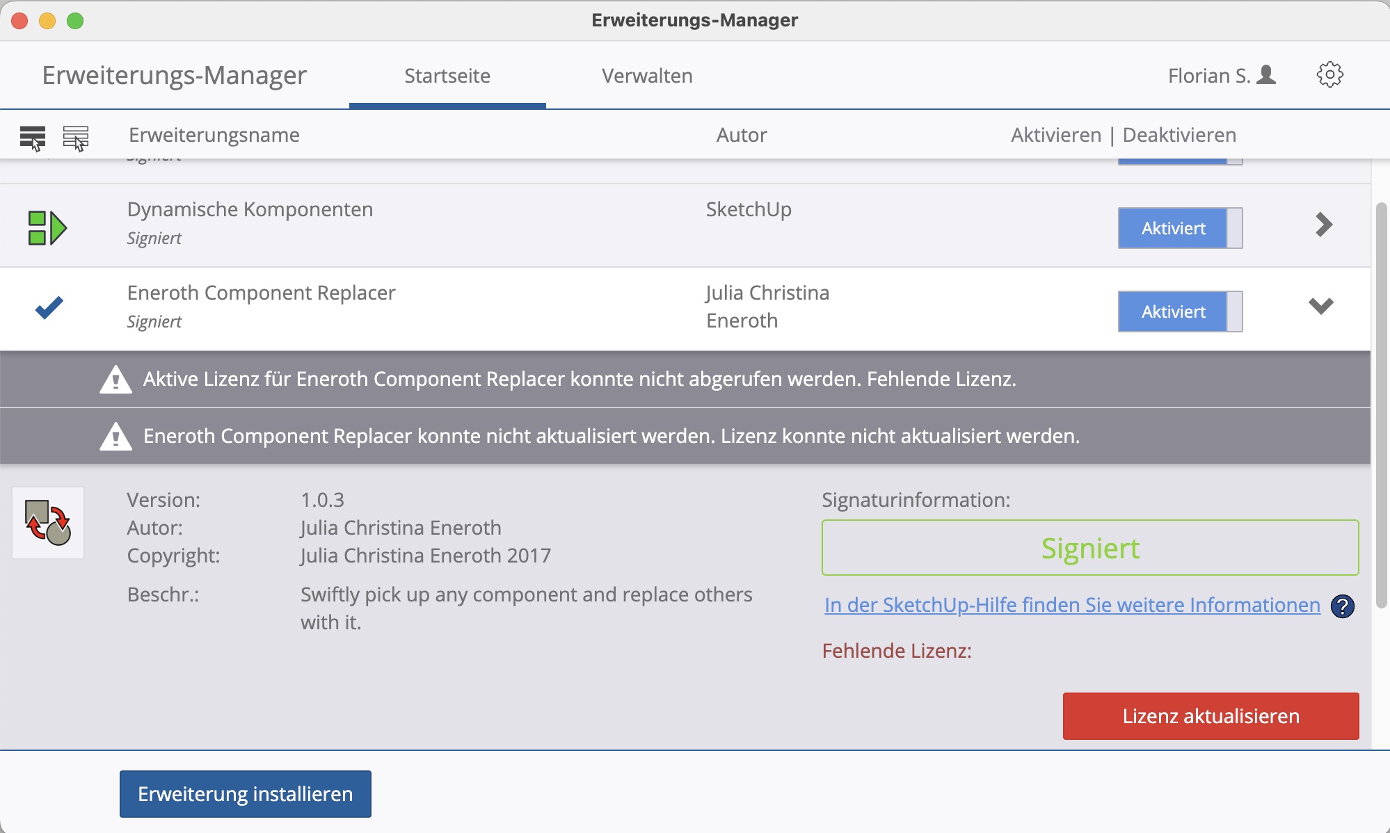

closed, started, new log in, provided credentials, bugsplat, started, login, started plugin,
Message “Eneroth Component Replacer isn’t licensed. Do you want to open the Extension Warehouse to get a license?” - yes - install - is installed - isn’t licensed …
sorry, it doesn’t work
The license is working on my two Macs. Can you try uninstalling the extension, and reinstall it again?
showed “missing license” | I deinstalled the extension | I closed SketchUp | I had to login again |
“not able to update license”
=> still not working
More fixes have happened. If the extension is not working now, try the update license button, if you see one (like shown for another example).
