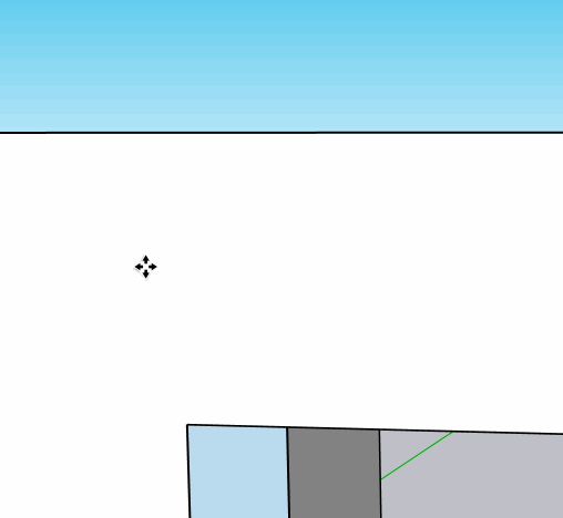

@jean_lemire_1 very informative, thx however i tried this simple example where i made the whole finally and then i tried to move the whole around after i grouped it (i also tried making it a component) but somehow i don’t move the whole hole but part of it even though i tried carefully to include every corner and face from both sides. What is the reason it doesn’t work ? window_hole.skp (279.8 KB)
Your example illustrates a misunderstanding of how SketchUp works. Edges and faces captured in a group or component are isolated from the rest of the model so they can’t affect it. And things from different contexts (model, group, or component) can overlap without interacting. When you create a group from the edges and faces of the hole, the original edges are still required by the original face because they define a hole in it. Duplicates at the same location are created in the group. It all looks fine because they are in different contexts. But when you move the group, you are moving only that group, without affecting the original face or its edges. That produces the effect you show.
You really don’t need to create a group to move the hole in the face. Just select all its edges and faces carefully and move them.
@jean_lemire_1 had a group for the window, but left the edges and faces of the hole loose so they continue to cut the face at their new location.
