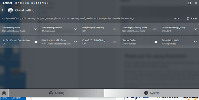

Usually the graphics control panel can be found by right-clicking on your Windows desktop. As @catamountain said, it is called Catalyst… and the settings should be found in Advanced view, perhaps under Gaming(!).
Anssi
Thanks Anssi, I have found some Radeon settings:

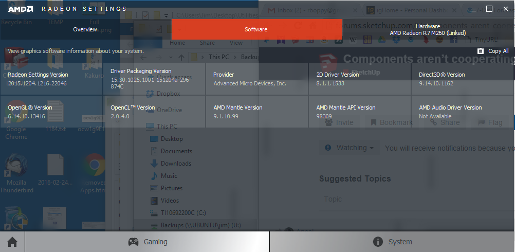

These are the gaming setting, I haven’t a clue which setting to change. And this is the Radeon installed software:Just info I think.

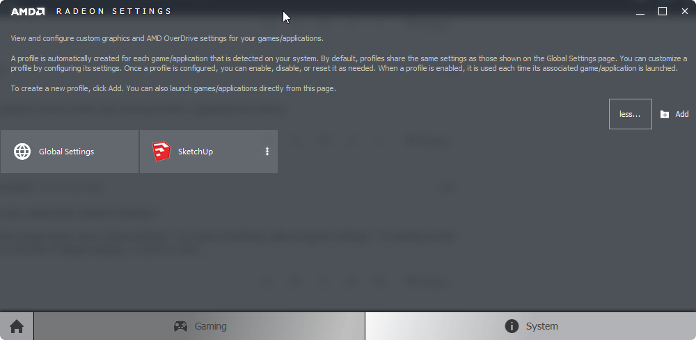

That first image above show Global settings. You want something called program settings. Try clicking on the arrow to the left of Global settings, or click on more… .
The left arrow is their back button, this is their more…,
I clicked on add and browsed to sketchup, clicking on sketchup just runs the software the first time, the second time you get this:

In general, anti-aliasing mode should be set to application controlled, which it is. And Anisotropic filtering can be set to application controlled too.
It looks like the AMD card is enabled for SU. What’s under Profile Properties?
