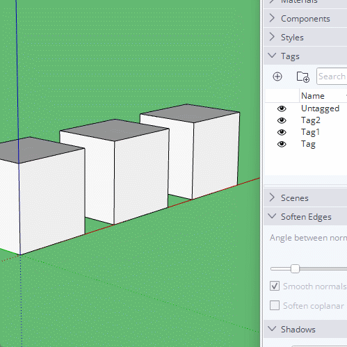

Here’s a very simple example.
Each cube is tagged but the 3rd one has mixed tagging of its geometry as well.
thanks for taking a look at my model and for your insights. You are safe, no-one was watching you ![]()
Thanks for the example. Makes total sense. I think if I just make sure that geometry is untagged I should be ok ![]()
