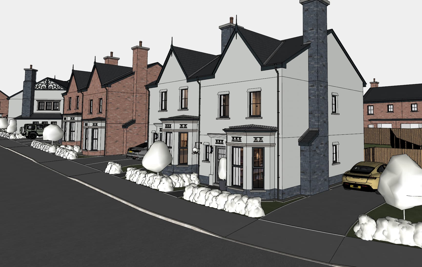

Screenshot of model:
Close up:
Render:
Basic Stats:
Edges:14.8m
Faces: 8.3m
Comp’s: 33k
CompDef’s: 466
Groups: 16.9k
Materials: 164
Slightly above typical for me, the cars are big poly hogs and there are a fair few in this model.
