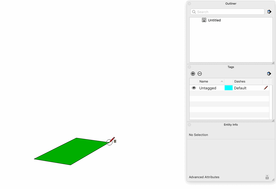

Previous to upgrading to version 2021.1, when I selected an object I could start typing a tag name in the Entity Info window, and if the tag did not already exist, hitting enter would create the tag and assign it to the selected object.
After updating to 2021.1, it appears this functionality no longer works the same, and tags must be created via the tags window first, and then assigned in the Entity Info window. Selecting an object, typing in a new tag name in Entity Info, and hitting enter just deletes whatever name was typed in and no new tag is created/applied. This is a lot less efficient, is this a bug or intended behavior?
