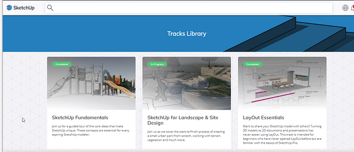

Have you started here yet? https://learn.sketchup.com

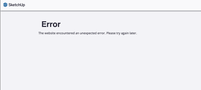

Thank you for your reply. I’m sorry but the link does not appear to be working.
It worked for me.
Hmmmmm… its working for me too. Try clearing your cache or using a different browser? Works for me on Safari, Chrome and Opera.

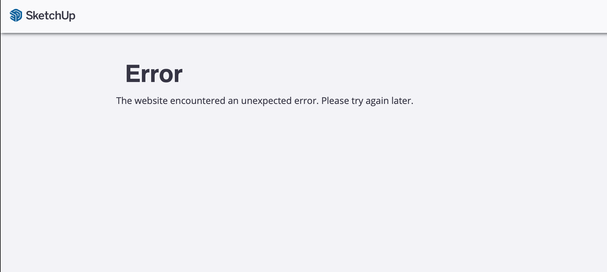

thanks Aaron, though it’s still not opening, but I have just found you on the sketchup you tube channel so I’m watching that at the minute. I have tried safari and chrome…maybe because I’m in UK?
It looks like there may be an issue with one or more servers. Keep it book marked, though, as I am sure we will get it back up and running soon!

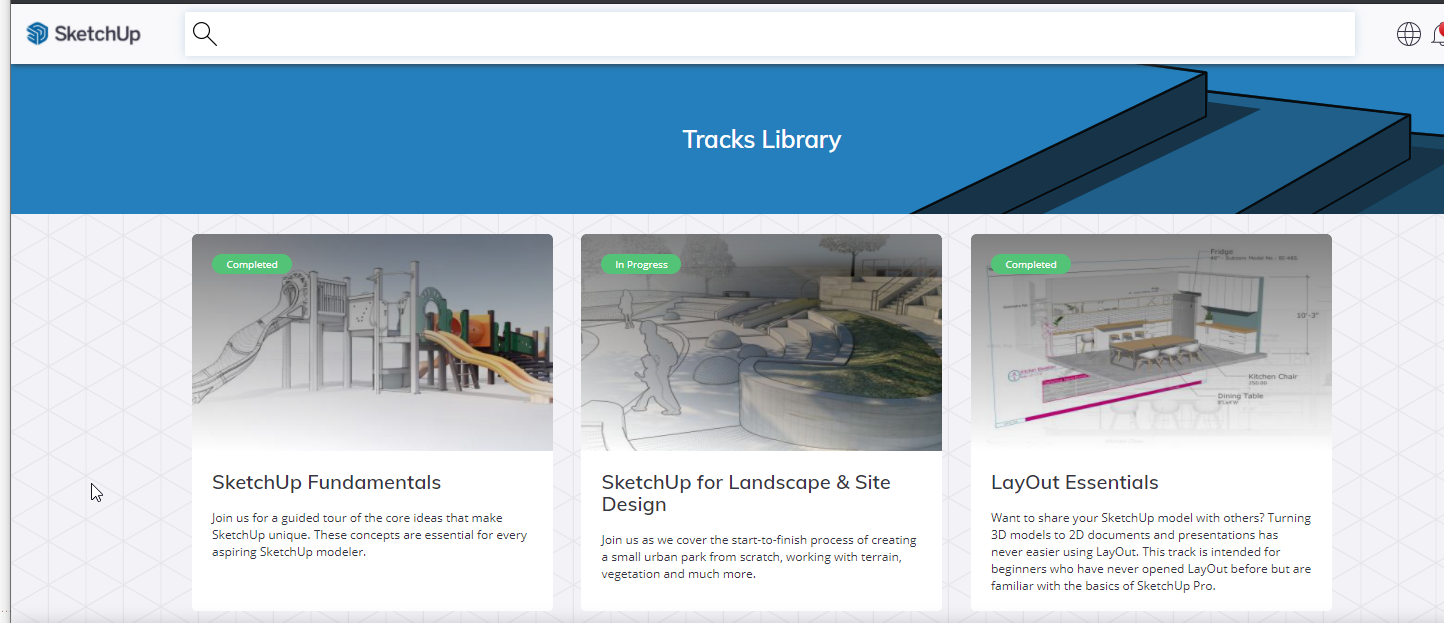

The link is working now in the UK on Safari.
