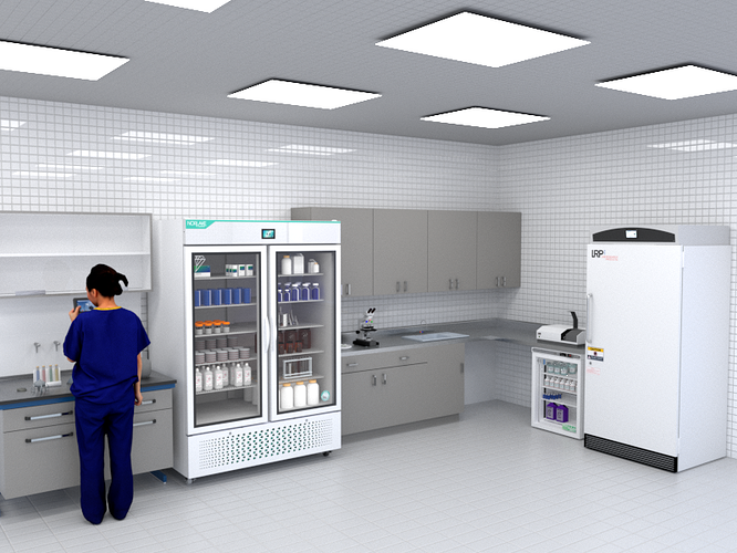

Good afternoon everyone,
I found a model in the warehouse that I would really like to use but she appears very dark and I can’t figure out a way to lighten the model or make it take on the surrounding lights in a better way. Can anyone help?

Have you tried lightening the materials in her or her clothes?

I just opened the her UV mapped material in Photoshop and lightened it, then reloaded it. You can see the difference here:

I think I figured it out. I went to the materials panel, right-clicked the material, chose edit, click on the dropdown and clicked edit again. the material opened in photoshop.
Thanks for tip!

Cool. Glad you got it. That’s what I was going to say to do. Then just click ‘Load’ and browse to your new lighter image to swap out and presto!
I think your model has vray 2.0 materials settings on it… Extensions-vray-tools-wipe option will solve it…
That would have been much safer than what I did, lol. I saved over the original in Photoshop without thinking about it. oops.

I think its texture is missing for vray, so you can turn hidden geometry on, right click and choose texture-edit and open and save with photoshop as you did before… Or just use vray file path editor and extract all textures…

Here is the material in File Path Editor.
The file path doesn’t exist on my Mac so if I’m understanding, should I open the texture in Photoshop and save it somewhere else? Then set a new path?

I can’t download your model and check but a quick guess, are the faces in the second figure reversed?
I just tried reversing the faces but it didn’t work.

maybe you can try to explode an regroup that person?
