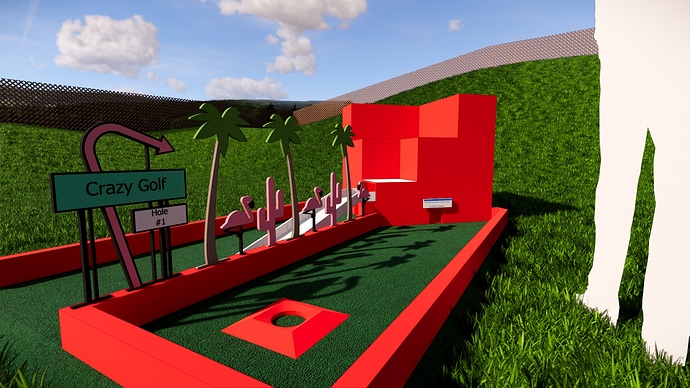

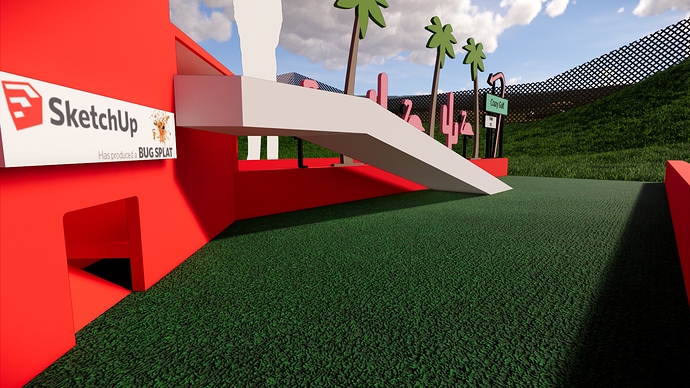

Found this challenge by complete accident and thought I would give it a blast…
Simple design, two ramps inside the Sketchup logo box. One ramp takes the ball back to the start the other takes the ball on the side of the course with the hole.
Bit of luck for which side the ball comes out but plenty of space to walk and take shots either way.
Will upload the model as soon as I get chance to tidy it up. Taken a couple of snapshots for now.
