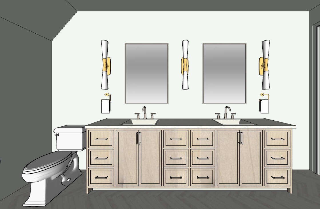

Hi, Dave! This is exactly what I do but it still distorts all of my models. For example, here is the layout of a bathroom that Im working on, but the photo I need is of the vanity wall. The entire wall can only be seen if I set the field of Zoom to 75* but look at that toilet! I just need a wide angle without the distortion… Is this possible?
You would get the same kind of distortion if you were taking a photograph in a real bathroom with an extreme wide angle lens. In SketchUp there’s no need for that. Use a section cut to remove the shower, tub and the wall they are on. Then set the angle of view to something reasonable and position the camera to show the vanity and toilet as needed.
