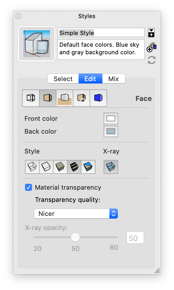

On SketchUp 2020 for Mac, the x-ray opacity slider under material transparency in the Styles palette is disabled, and the faster/nicer pop-up menu is also enabled and disabled incorrectly. I feel like SketchUp 2020 has some control enabling/disabling issue in this palette…
When material transparency is checked, the opacity slider remains disabled when nicer is selected, and the opacity amount in the also-disabled number field sometimes displays “50” and sometimes displays “65”. Also, the faster/nicer pop-up menu is not enabled and disabled correctly when the material transparency checkbox is enabled and disabled… You can uncheck the material transparency checkbox and the pop-up menu remains enabled, but switching the style tab to edge and back to face will update it. I can also get the material transparency checkbox to be disabled and non-selectable after a bit of random button-clicking in the Styles palette. So something is very amiss.
As a software developer myself, I was hoping that my post was clear enough, but also I run into reading users’ bug reports and scratching my head To clarify, in the Mac 2020 version of SketchUp, the X-ray opacity slider under Material transparency is not enabling properly. It doesn’t matter whether you are in X-ray mode or not, the slider does not become enabled, for me. And the Faster/Nicer pop-up also misbehaves at times, not accurately enabling and disabling when the Material transparency checkbox above it is checked and unchecked.
My assumption is that either there is some event handling that changed in 2020 that is the cause of this, or there is something corrupt in my machine’s prefs files that is having an effect on this setting. I would like to know if anyone else is seeing this issue.
So fi you click on the X-ray button does the opacity slider become active. In your screen shot you have the Face Style set to Shaded with Textures but X-ray is not shown as enabled…

Nope. The slider is permanently disabled. This worked in 2019, and I just happened to want to use the “nicer” setting in a model, so I have only noticed it now in 2020
And to add clarifying details, the material transparency setting is working properly, the faster/nicer setting is also working correctly, and x-ray mode is working fine. It’s just that the opacity slider is permanently disabled, for me.
