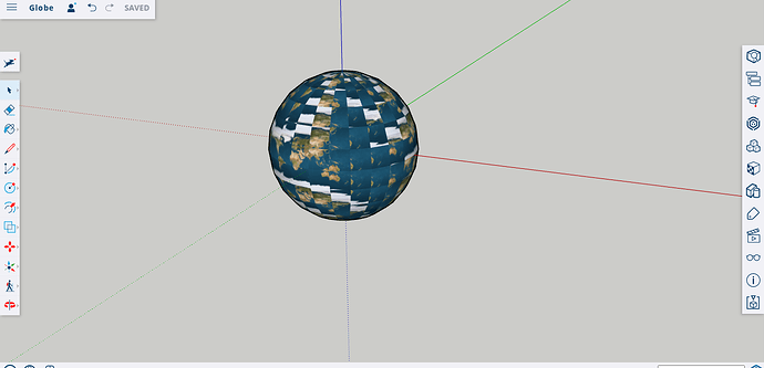

jimhami42, you showed in your video a round map of earth. When I used the rectangle map you posted and used eyedropper/fill the globe came out like the screenshot. I couldn’t open the other sphirix video. How do you make the map circular?

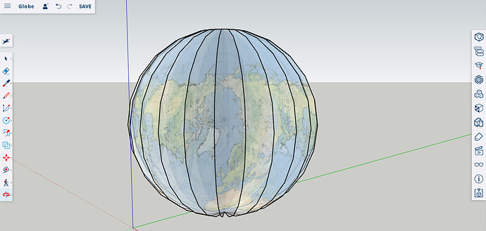

I have several videos. The one with the eyedropper uses a polar map, and not the spherical map in my previous post. The hemi-sphere needs to be softened before projecting the image. I hope this helps.

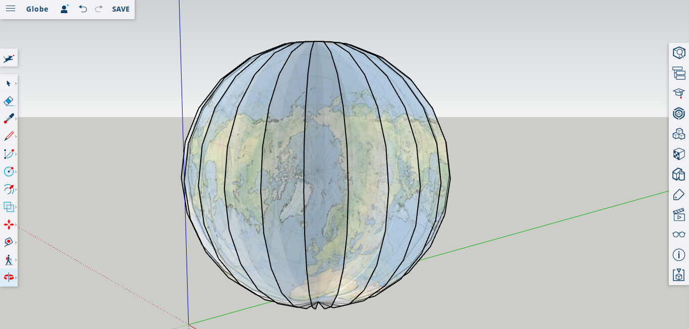

I was playing with the Arctic Map and ended up copying inside the globe 24 times. When you spin it, you see the continents a different angles. It’s not right but interesting.
