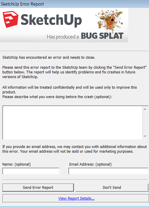

Endless glitches. This software is junk, how are they actually charging money for a “pro” version of this?

Two things: saving to a L:Drive (server/usb?) causes problems, depending on the file size and autosave-settings.
HD Internal cards are known to have issues with OpenGL, yiu need a dedicated graphic card for using SketchUp.

Same file exception BS happens whether it’s a USB drive or just my C drive.

Z-fighting doesn’t seem to be your problem though. It seems to be a problem with overlapping faces in the same drawing context. This is not a Z-fighting issue (rendering) but a problem in the underlying geometry. In some rare cases SketchUp fails to properly create faces and create this overlapping ones. I would erase the outer face and try to re-create it by drawing edges between the outer edges of the inside faces and the outer loop of the outer face. The risk of SketchUp producing overlapping faces can also be reduced by using several groups and components, rather than having all geometry in the same drawing context.

Yes, the software should never crash just because the user does something the software allows.
