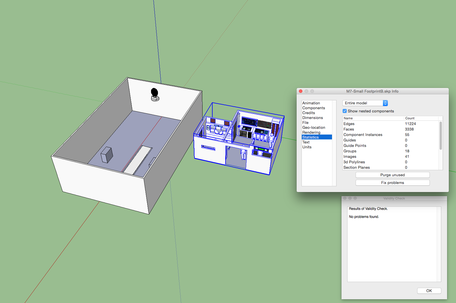

According to model info statistics, there are 42 images in the model. Unless you were careful to prune them down, that is sure to run up the size of the model.
There is z-fighting on the wall in this screenshot, but otherwise I am not having any issues with zooming or orbiting the model on my MacBookPro Retina.
Well, the colored objects are indeed unexploded images. You’ve got a bunch of reversed faces, which don’t seem to be the problem. No z-fighting (except as observed by @slbaumgartner) . No clipping.
Going all the way back to your first screen shot, I don’t see any of the triangular artifacts.
Maybe Wo3Dan is right about your video card. To confirm that, try going to Window > Preferences > OpenGL and turning off hardware acceleration. What happens?
