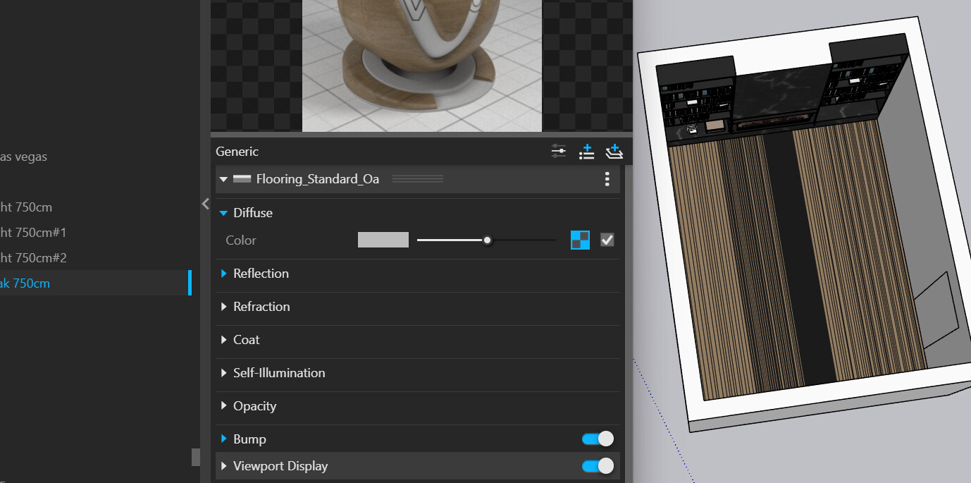

Why i can not add Vray floor texture on my design
When i try to add texture for my floor, from Vray this is how it comes out. Any one has an idea why please cause i am getting very frustrated.

The texture appears different in the file you shared.
Opening the texture in an external editor show it looks like this:
You can also see that if you opt to position the texture in SketchUp.
There’s a large black stripe on one side. Did you change the dimensions of the texture in Vray or in SketchUp? What are you expecting it to look like?
I am trying to add herringbone wood flooring. When i add from Vray it comes out like this
