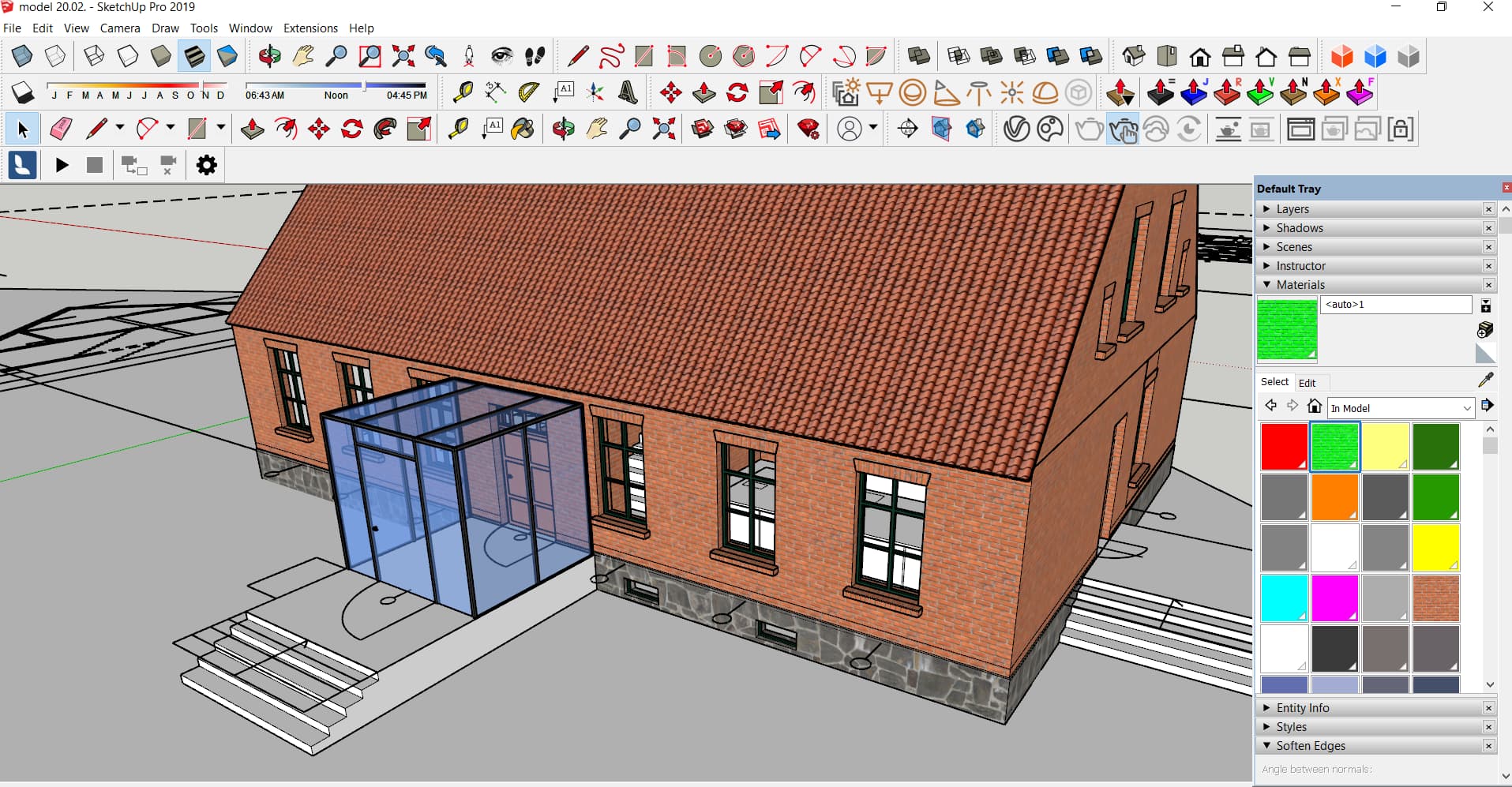

Hello there,
I have a problem with my Sketchup Vray. I added textures by dropping a jpg image from dekstop and spent hours positioning it properly [photo]. After starting render these textures don’t show up. However, a glass texture which is available in the materials menu does render [photo]. I noticed that the texture doesn’t appear in the materials tab. After adding a new material from the materials menu it renders properly, although I don’t want to spend a lot of time positioning the material again [photo]. Is it somehow possible to convert the image to a proper material in order to print it?

I added a jpg texture by dragging it from the desktop and dropping in Sketchup, having a particular group selected (eg. group with all exterior walls). I used pipette/dropper tool to select the image and painted the walls with paint bucket tool. Then I adjusted the texture using “texture → position” tool. I scaled and rotated the material properly.

I exploded the material, saved, quitted and reopened the model. The image didn’t appear in the materials tab in Sketchup. It is also not present in the materials tab in Vray. I’m sending you the model along with the image source files in the next reply. Please check it yourself if you can. Thanks for help.
I turned “override materials” option off. I exploded the face and reopened Sketchup. The problem in my opinion is that the material / texture / image doesn’t show up in the materials tab, neither in Sketchup nor in Vray. I could add the material manually and convert the walls faces to it but then I would need to reposition and rerotate every face again, which really took me hours and I really want to avoid it. I am sending you guys the model along with the source jpgs of textures (with google drive because the files are too big). Please check it yourself whether it is possible to convert the image to a material.

There are four of those “materials” in your model: the tile roof, the brick walls, the wood in the door and the stone foundation. The evidence is that the textured shows up even if you turn on Hidden Line or Shaded display mode. The reason is indeed the bug that allows an image to be used as a texture if it is within a group or component. My solution would be to re-import the images and before painting anything, exploding them, or importing them as textures in the first place, or creating new materials in the materials browser and adding the image to the “texture slot”.
