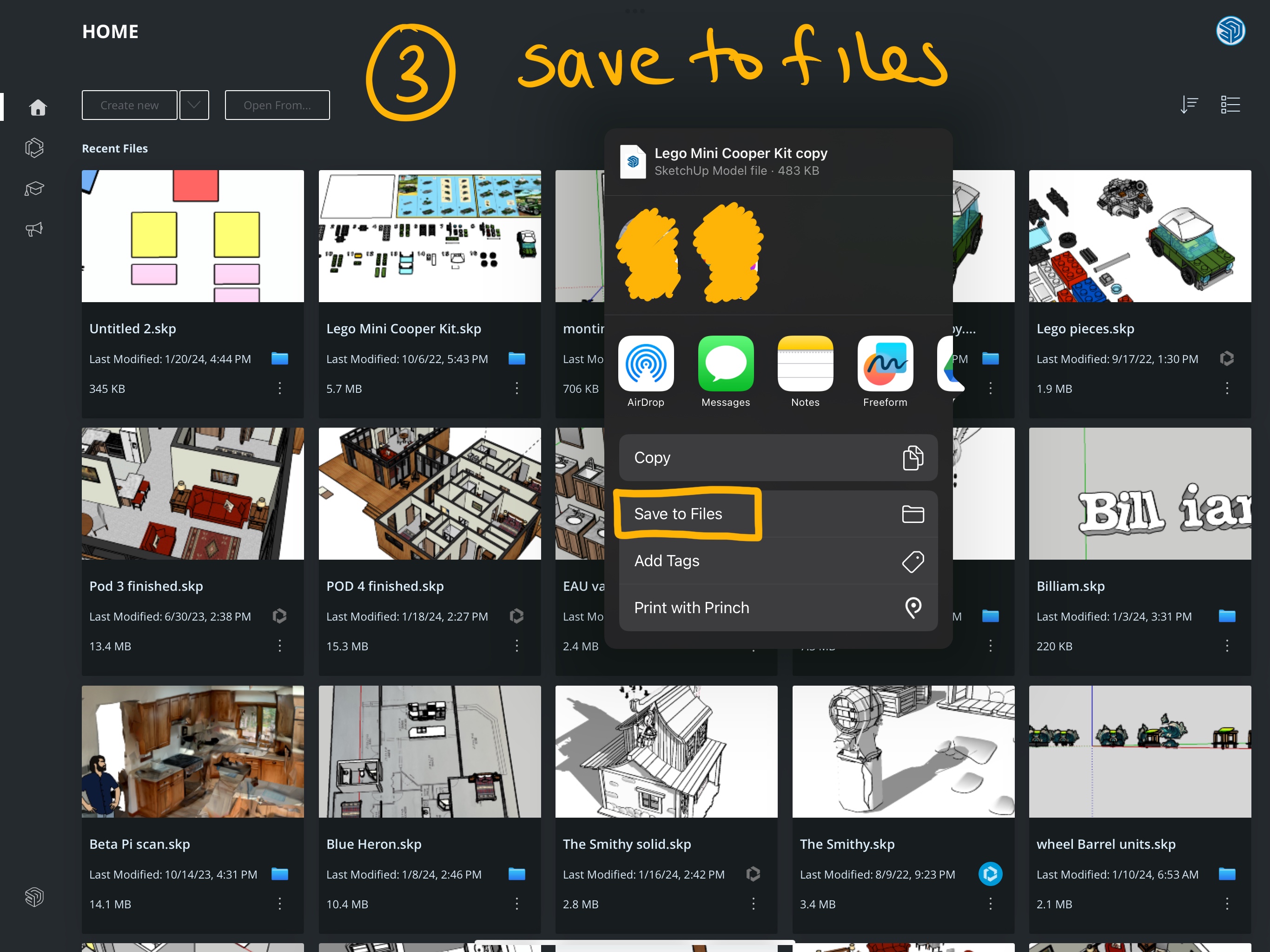

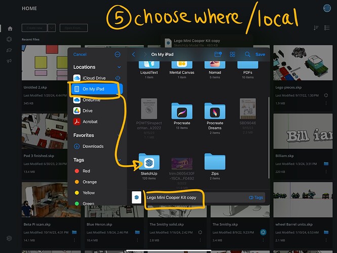

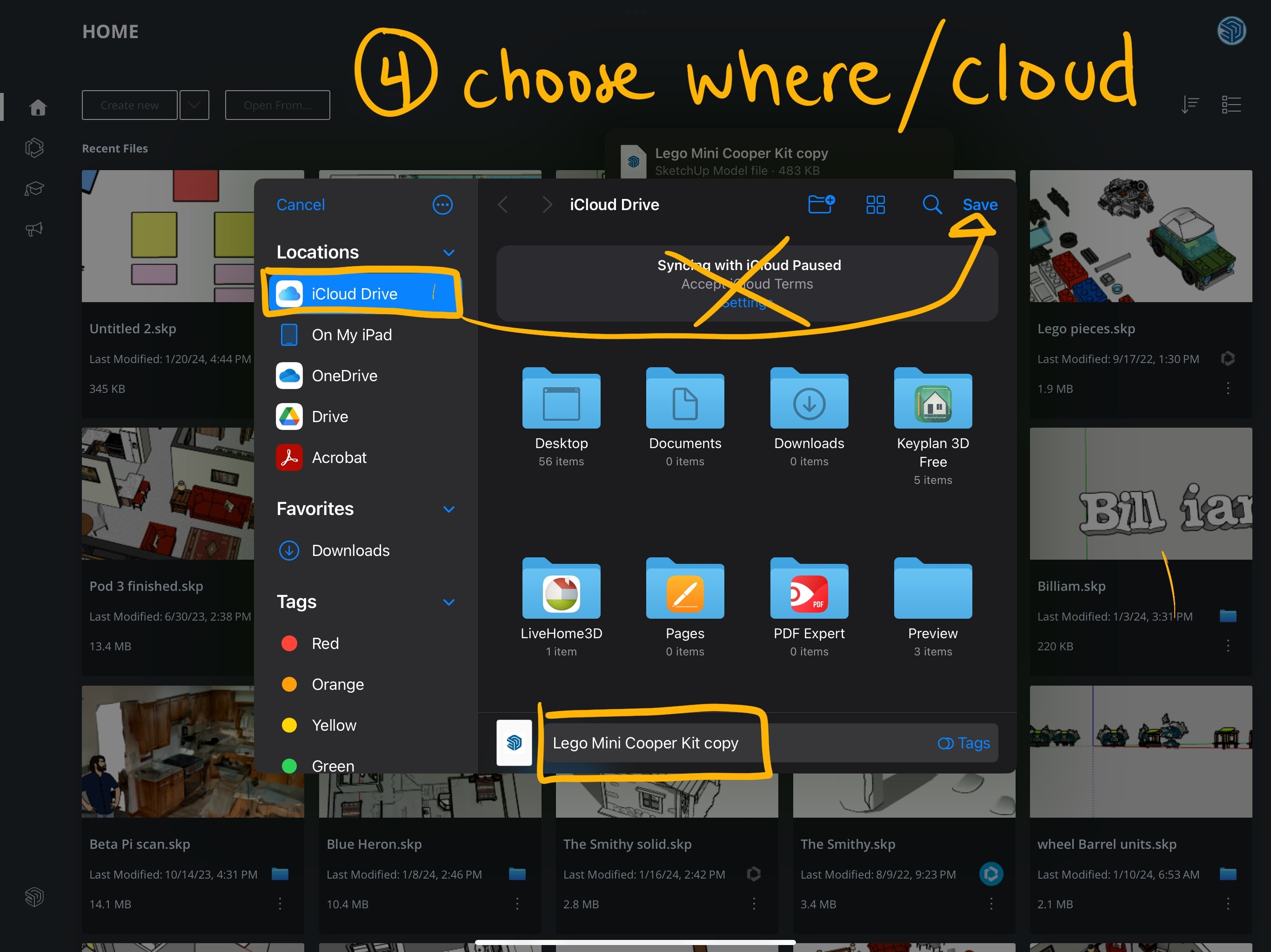

Also, the App is not saving to the Cloud so drawings were unavailable on the ipad or iphone. I did try and move that folder to iCloud but it defaulted to local storage.

Meanwhile, if you want to share sketchup files from your computer to your ipad, you have to go to the web app :
https://app.sketchup.com/app
The “free” web app is the bridge between all your versions, any file uploaded there will appear on your idevices. and will also be accessible from any other computer, using the web app (or downloaded there to use on pro)
Not having had an iPad for years now, I’m not sure how sketchup on ipad manages it’s folders, and if you can simply add files to iCloud - from your experience it looks like no, but the web interface should work. Until someday we have a Pro tool to upload / download fro sketchup’s cloud at least
