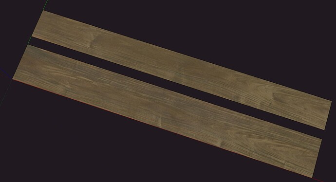

FWIW, you can make your own textures, too. I’m not a fan of the commonly available wood grain materials because they aren’t large enough for most projects. Instead I use images of full length boards. These are a couple of my Ipe materials.
