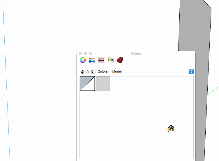

I can’t figure this out for the life of me. The official Sketchup documentation says you can colorize your textures, and multiple tutorials online explain how to. However, the options mentioned in both are not actually visible in my Sketchup (2017, Mac, Make edition). Am I missing something?
scroll through this, it may help?
Make sure you’re selected to the brick tab in the Colors palette:
There have been times when the Colors palette didn’t look right, especially after an update of the application. If it doesn’t seem right you may need to reset the preferences. See this topic:
