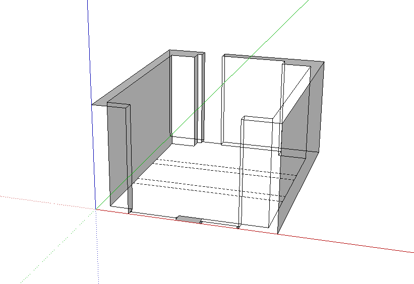

I have tried to play with the styles and temporarily works, but whenever i orbit, the surfaces disappear and i don’t know what else to do. Right now, i’m using in model - simple style and the only selected ones from edge styles are “edges” and “profiles”.
Typically you can see this behavior on very large poly heavy models. Happens because the graphics card can’t “keep up” when orbiting. On a simple model it leads me to think your graphics card is not suitable for running SU. Just a guess because the information in your profile about the computer your using is just nonsense.

If you orbit and then wait a while, do the faces finally paint in? It is normal for SketchUp to show wireframe while orbiting or panning if the graphics card is too slow to keep up, but it should catch up after a short lag when you pause. Because this is happening on what looks to be a very simple model (I assume there isn’t more stuff hidden or off the view), it indeed suggests that your graphics are not adequate.

Hmm, just to rule out the files themselves, could you share with us a file where this happens ? so we can check on our end?
It’s probably not it, it looks like your machine has some trouble rendering the elements, but who knows, could be a combo of weird parameters.
To do that, simply save a problematic file like the one shown, and drag it here in the answer window.

I used SketchUp Make 2017 on my previous laptop which had Intel UHD integrated graphics only. No problems whatsoever with simple models but indeed wireframe during orbiting and panning on heavier models. A second or so after stopping orbit or pan the model would look normal again. If this doesn’t happen, share your model so we can test it.
