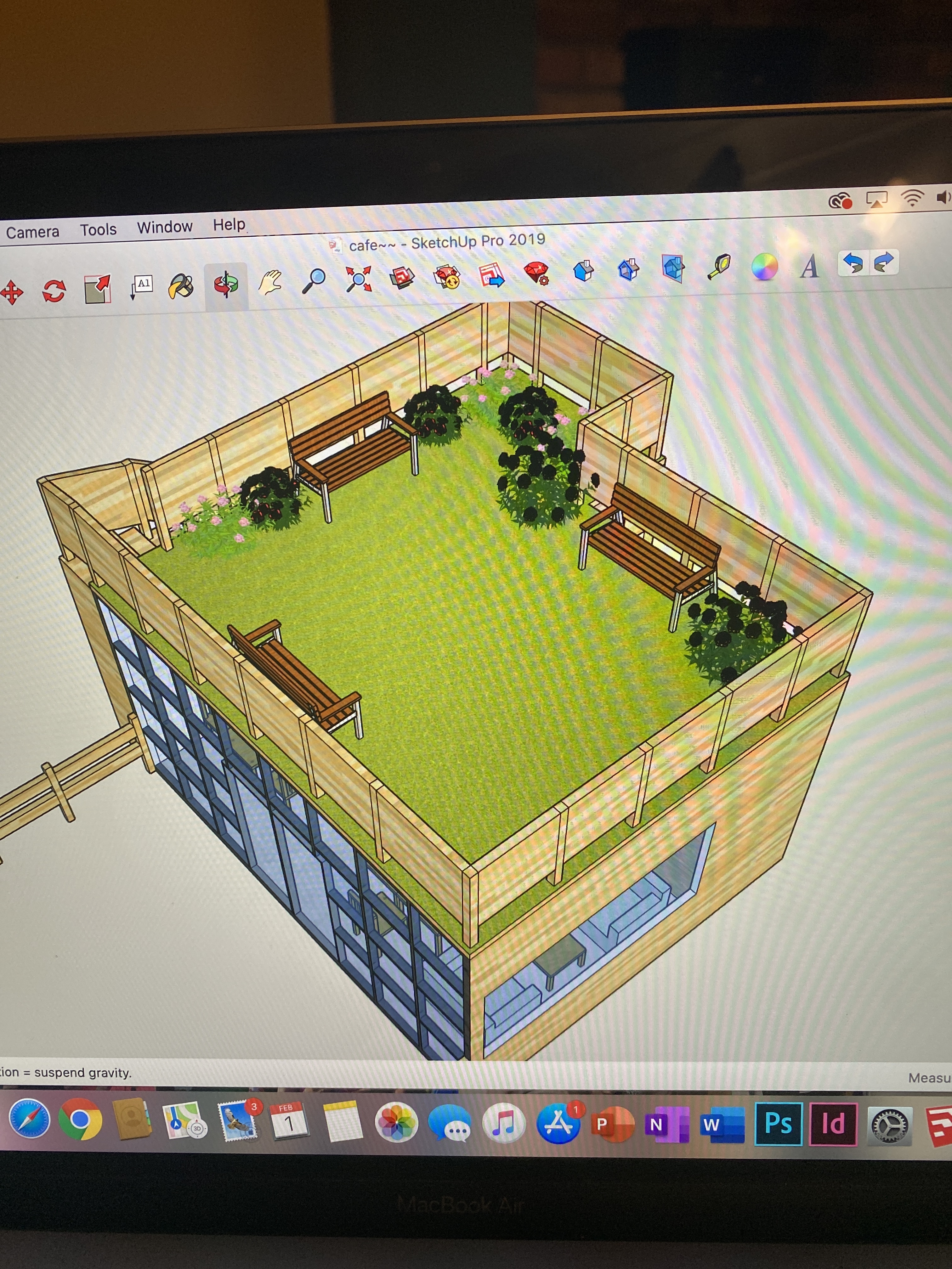

Whenever I click on my modem to zoom or orbit, my modem gets rid of textures such as wood and turns them to plain colours (grass will turn to a solid green) and also a load of black lines will show up on my model. This only happens when I click on stuff ! (You’ll have to click on the photo link because only 1 will show up when I’ve uploaded 2!)

The losing of texture and showing of boxes is to make the orbiting keep up. When you stop dragging they will come back.
What is most likely being demanding enough for the textures to be hidden is your vegetation. If you could find a simpler version of those models everything will improve.
