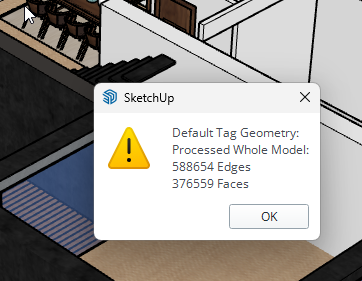

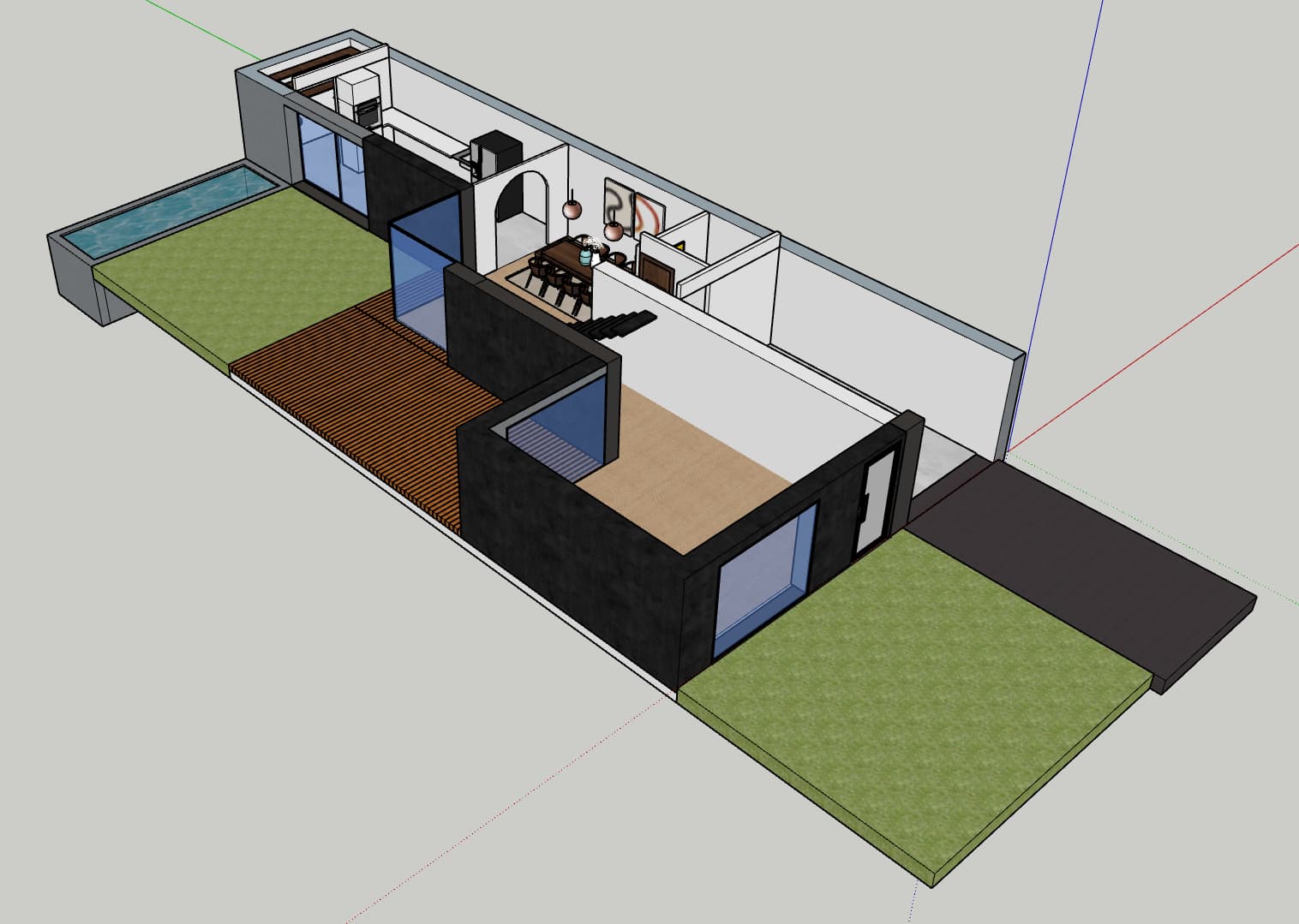

The file you named TP MAISON.SKB.skp is about 85% filled with zeroes. The other file opened fine after I renamed it to TP MAISON.skp and I get this.

BTW, it would help if you fix incorrect tag usage.
And purge unused stuff from the file. You’re hoard a lot of unused components and materials.
