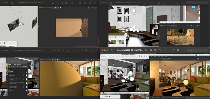

Random objects seem to be appearing in the vray render (both interactive and render function) but are not visible in the sketchup model. After some digging, I have found that when I toggle on and off some of the lights (e.g. spot lights, sphere), the objects seem to change size and shape. I have also noticed some of my vray chaos cosmos models (such as trees) are not appearing in the render. The objects/geometry are very random and not something I have created myself. Has this happened to anyone else? I am lost for what to do next!
I have tried force quitting the app, saving it as a new document and restarting my computer and nothing seems to be helping. I have also tried reopening the document through my linked layout file to see if this had any difference. I have been working on this model for a few weeks and produced lots of renders already with no issues, so it is not a new model either. I have been using vray for a few months and i have not had this issue before until today. I am using a Mac Studio M2 Max chip.

Ive tried hidden objects, and I have also gone through all of my tags to see if there was anything hiding and nothing seems to be working. The shapes seem to appear and change every time I turn on or off a vray light. I have turned off all the lights except the sunlight and the objects change shape and size, but are still there. The shapes are also appearing in places I haven’t placed lights as well.

I tried resetting the vray settings and nothing changed. The problem still seems to occur when switching the vray lights on and off. Some chaos cosmos models are also not rendering at all.

I have also tried another model to see if it is just this file, and it also seems to be having issues. It all looks fine on the render interactive, but as soon as I hit render something strange happens.
