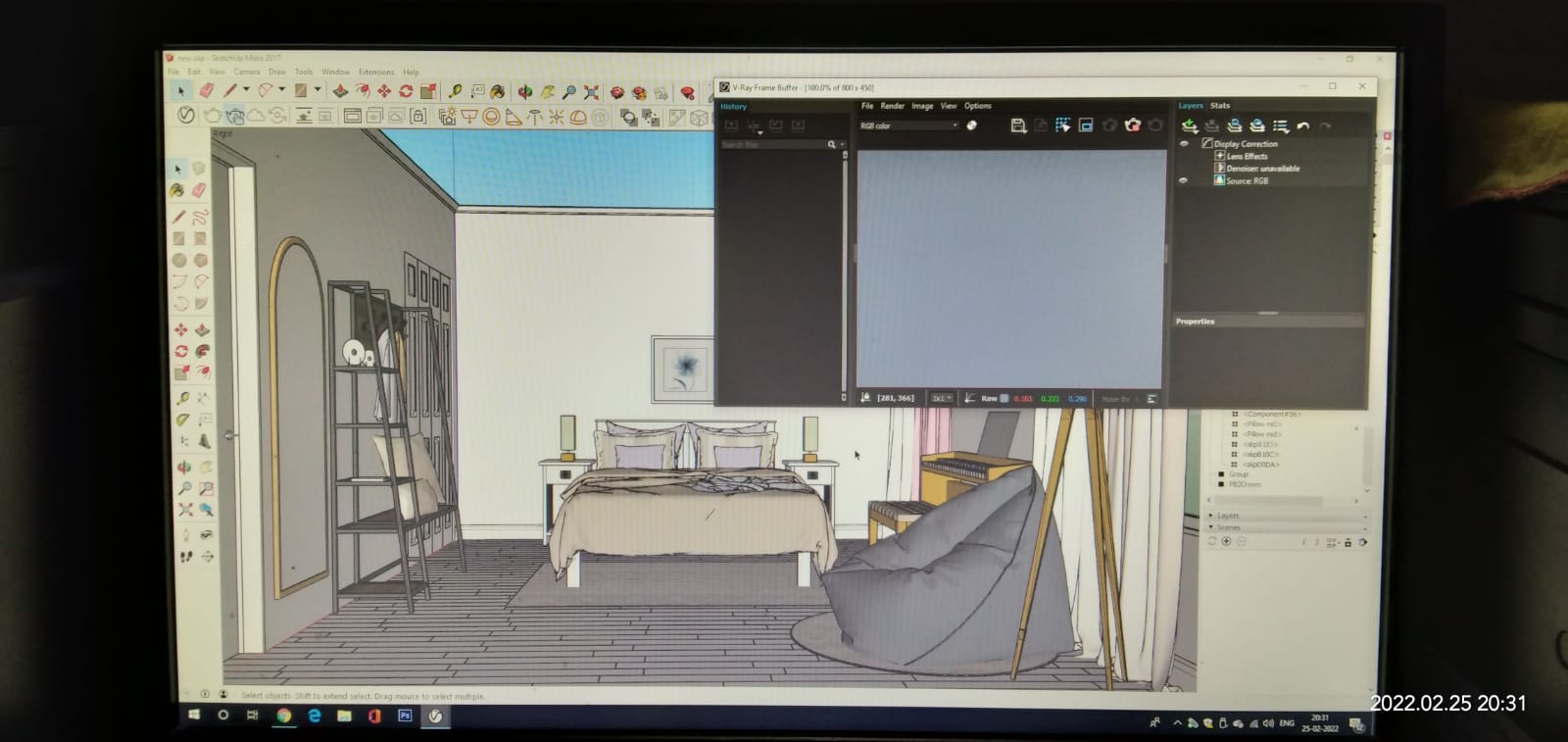

I am facing an issue while rendering. I am using sketchup make 2017 and vray 5. my render turns out completely white. How to fix this?
Can you provide some more information? Please post a screenshot of your model and VFB (V-Ray Frame Buffer). Also is this the first time you’re using V-Ray? Is this the first time you’ve had this problem? Do other models render ok?

Hard to see, but looks like you might have rectangle light right in front of the camera?

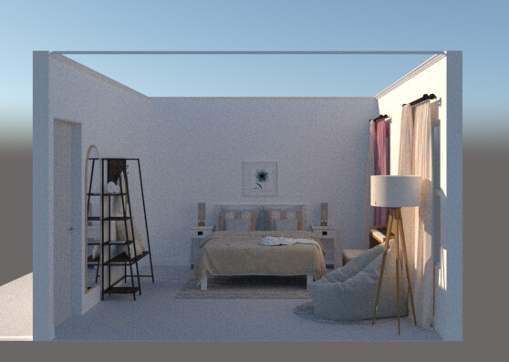

I get this when my view has an active section cut but section cut display is turned off. But what I guess from your screenshots is that you have placed a section cut exactly on the inner face of the wall, and SketchUp decides to cut the wall while V-ray preserves it. Try moving the cut so that is inside the room. Or, you have two active section planes - I get somewhat weird results with them.
No i dont have 2 active planes. Also tried moving the cut inside.
I opened your file, aligned the view with the section cut and hit the render button.

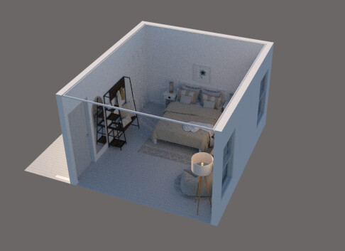

I right-clicked on the section cut and selected “align view” from the context menu. I am sure that that has nothing to do with the problem. This is what I get by opening your file and hitting the render button without changing absolutely anything:
