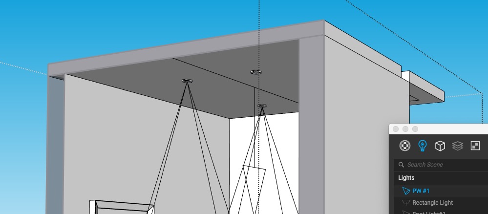

I note that you are using Tags incorrectly.
Screenshot - 11_29_2021 , 1_20_31 PM
Untagged should always be active and all edges and faces should be created and remain untagged.

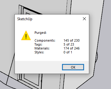

Purge unused stuff once in awhile, too. I did that and reduced the file size by about 56%.

When you are making the render are you seeing the section cut? What happens if you correct the reversed faces of the ceiling?

If the section cut remains where it is in the picture you screenshotted then I don’t see it, but if i move it forward so it actually cuts past the wall, then yes I see it in the render

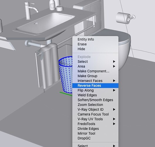

Make sure to check your model for reversed faces (using Monochrome face style) and reverse all the blue faces (ie back faces) so they show as white. Reversed faces will cause problems with your materials and render.
